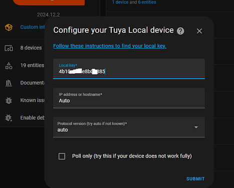

Sadly I have installed the integration and can choose the thermostat in setup but it cannot find the IP so I enter it manually (I know it is correct) but it still says “Unable to connect to your device with those details. It could be an intermittent issue, or they may be incorrect.”
Any thoughts?
Static IP address
Try a few times
I keep trying, if I use auto for IP address it comes back with ‘Unknown error’ all the time.
Using actual IP address it returns ‘Unable to connect’
See attached

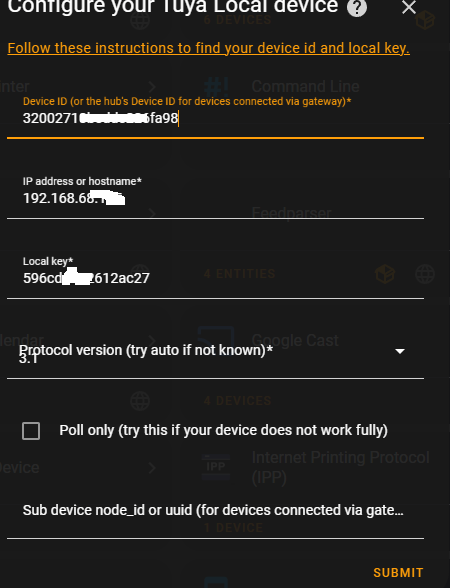

Sorry should have asked for local_key not device id…now edited to ask the right question…
So how do I find the local_key? It auto populates with the screen grab I shared but if this is wrong where is the proper key?

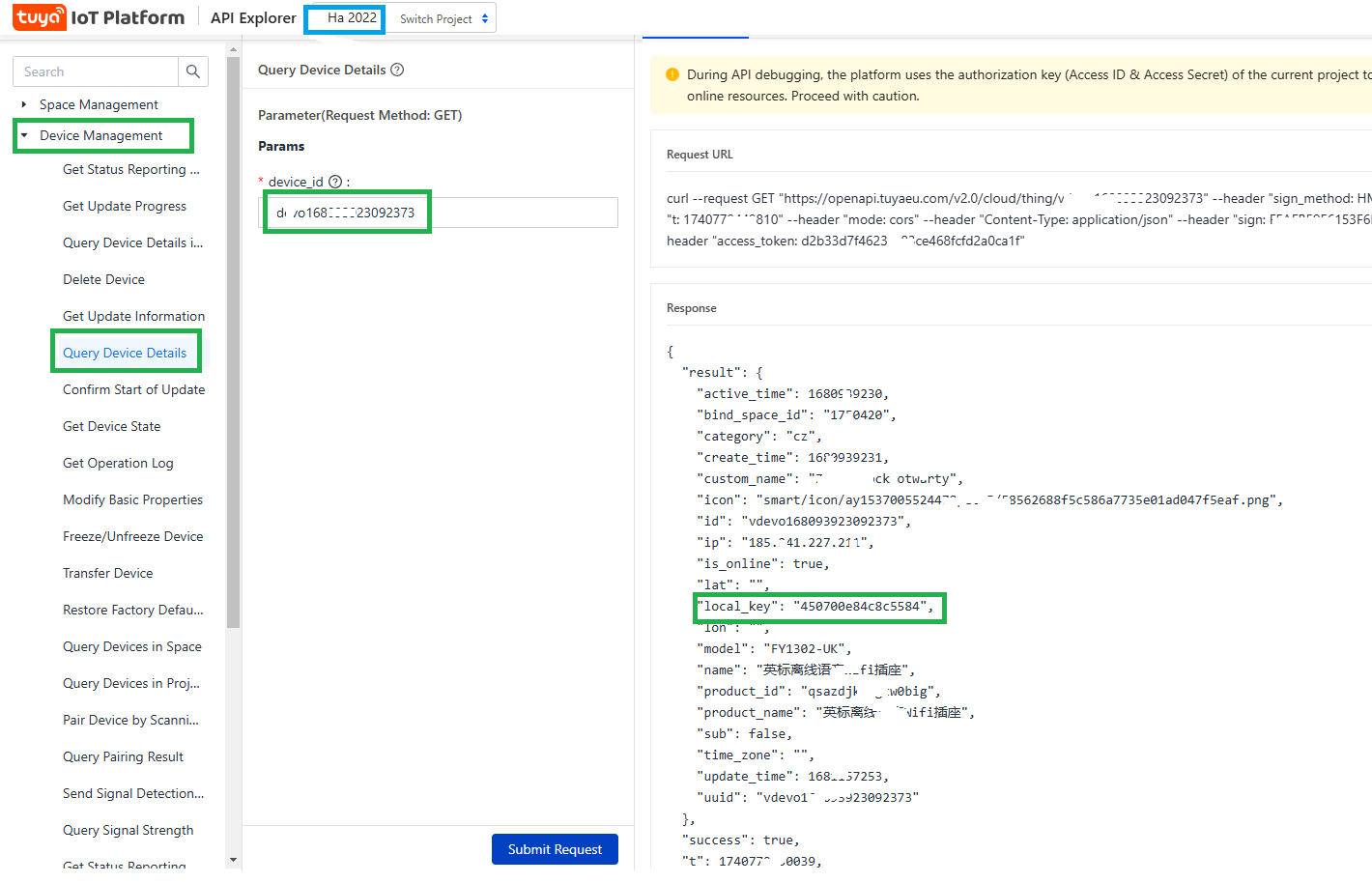

I finally managed to get the local key:
  "lat": "51.9211",
  "local_key": "3E'o?:OCd7SD15?)",
  "lon": "-3.5466",
However Tuya-local still cannot find the device (a MOES thermostat).
Any ideas?
The correct local_key for Tuya devices should be 16 alphanumeric characters (letters and numbers only, no special characters).
Example of a valid key:
local_key: "a1b2c3d4e5f6g7h8"
So why am I getting what I am in the Tuya IoT platform?

I tried this with the strange local_key I get but still nothing I’m afraid.
I really appreciate your ongoing help with this.
I also tried another device (a light) in the Tuya IoT platform and that returns a strange result as well
” local_key": "'#`tH)HrHv^1F!*e”

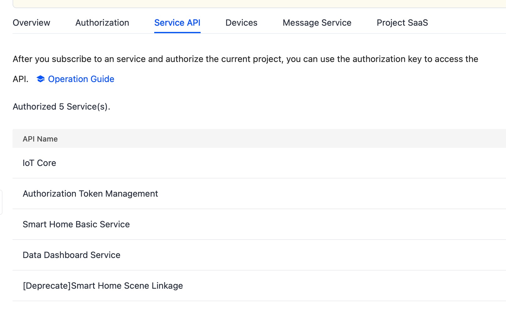

How to extend the validity of the Tuya API?
  1. Go to the Tuya IoT Platform.
  2. Log in to your account.
  3. Navigate to Cloud → Projects and select your project.
  4. Click on the API Services tab.
  5. Find the “Smart Home API” service and click Extend.
So I get as far as selecting my project. There is no ‘API Services Tab’, but there is a ‘Service API’ - I assume the same thing? So I select this.
Then what I see is:
Then no ‘Smarthome API’?
Sorry, am I being a muppet?
But if I select the ‘Smarthome Basic services’ option it says it is ‘Permanent’ and no extend option.
