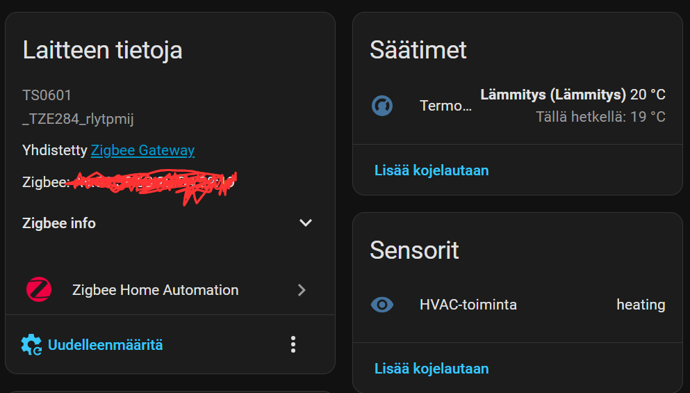

I (basically ChatGPT) managed to create some kind of quirk to this based on generic Tuya Thermostat quirk and the work that was done in Z2MQTT with this thermostat (TS0601_TZE284_rlytpmij).
The model I have is this https://moeshouse.com/products/zigbee-smart-thermostat-programmable-temperature-controller-water-boiler-electric-heating?variant=50590497964347
I’m still testing this and appreciate corrections and suggestions. I don’t have any idea if the code is reasonable or pretty. The code has also some Finnish comments :slight_smile:

Hi @timofin
Nice work. Thank you for this. I replaced the ts0601.py quirk file with your code and I at least get current temperature and target temperature shown now which is a great start.
If I modify the target temperature in HA it reflects this on the thermostat.
But if I modify it on the thermostat HA doesn’t update. And similarly when the current temperature changes this is also not updated into HA.
So it seems to be one way at the moment. Are you seeing this as well?
Kind regards
Richard
Hi @RichHA
Yes I seem to have the same issue.
My prompt (in short) to ChatGPT was to:
Quirk debugging is quite time consuming due to the need for restarting HA and re-pairing the devices between every change. I’ll try to debug this at some point. Please let me know if You find any corrections.
@timofin this works great for me! Thank you for providing that quirk.
If I change the target temperature on my thermostat, I can see it update in HA and so does the current temperature.
Have you found a way to measure power consumption of the thermostat?
This seems to work. ChatGPT did this so I can’t really give more information on this :smiley: This took about 100 iterations/tries, really annoying.

# /config/custom_zha_quirks/TZE284_rlytpmij/__init__.py
# Importing the module is enough; it registers the quirk (builder) or exposes MoesThermostatDevice (fallback).
from . import ts0601_thermostat_rlytpmij  # noqa: F401
Thank you for sharing. I and Claude run over the code, too, and got it reliably working including the preset selection: https://gist.github.com/taschik/ffebd3c685b4392a57bfa8d79a0d2ac1
I have yet to figure out how to get the currently active preset to show up in the thermostat card. I believe it requires a preset_mode field which I was not able yet to expose. But this also works reliable to report changes back to HA.
If you are interested, I added a power and an energy sensor which track the estimated energy usage of the my floorheating when turned on.
I am using an input helper to configure how many “watts” the floor heating uses and use it as input into a template sensor:

Thank You for the reply and the alternative solution. I will give it a try. I bought six peaces of these new Moes models and had two older ones (TZE204_aoclfnxz) in plase, thought that the same quirk would have applied - well no :smiley:
While the thermostat was updating correctly in both directions when I shared my quirk earlier today, I have trouble getting updates from the thermostats at the moment. It might have something to do with running multiple (8 pcs) of these thermostat.
My Terhmostat is for water circulation floor heating, so the energy calculation is a bit difficult - I whould have to know the supply and return water temperatures and the flow rate to calculate power and energy. Thanks anyway for providing the example for this also.
