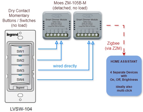

Moes ZM-105B-M zigbee dimmer module ... anyone have experience with it?
Anyone use these modules and have feedback on how well they work with Z2M and HA?
I want to use the Moes ZM-105B-M zigbee modules only as a converter between 4 momentary buttons (dry contact switches) and Home Assistant … no load will be connected to the switches or modules.
State functions I need in the HA Entities are… On, Off, Dim (bright level) and ideally Z2M would expose double click

Hi, im thinking about purchasing this exact model. Did you got around buying/testing it? If so, how did it go?
Moes support told me it could not work in detached mode so i didnt try it. I used a Shelly i4 and published a blueprint for it that also allows dimming since that did not exist. Works great
How did you do with Shelly 4?
I need something zigbee to be activated by click and control zigbee light with dimmer. Have you done this with Shelly i4?
Can you explain better how you did it please?
