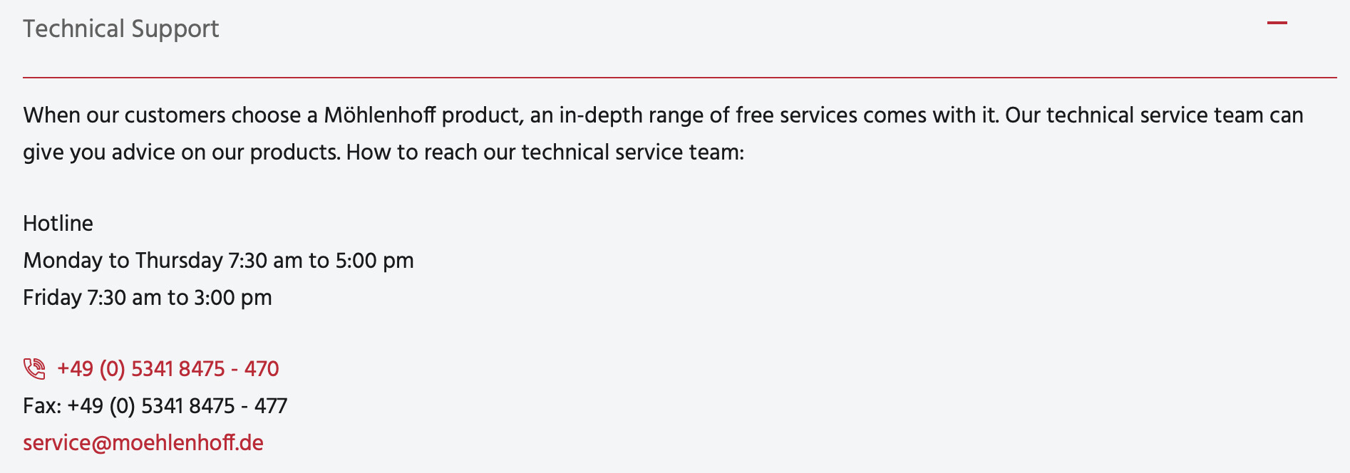

I received the files from the service department some time ago now. Maybe in the meanwhile there are other firmware updates available.
Best is to get in touch with them:
