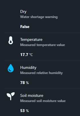

When viewing in Zigbee2MQTT it reports dry as false, but when I add the entity on a card it shows “Off”
any clues on how to change or do I just live with it

Ok sorry Solved it, I went into MQTT and changed the show as to moisture and that worked, sorry for the post
Ok not solved…when I select show as moisture it just shows “dry” but its not as per the picture…arghhhh
Ther is no device class for dryness afaik, just wetness, so I would pick problem. Then it is ok or problem. Your other option is to create a template sensor that says whatever you want it to say. You will get to pic the icon too. But having it light up when a problem exists is a bit harder, requiring card mod in the front end.
