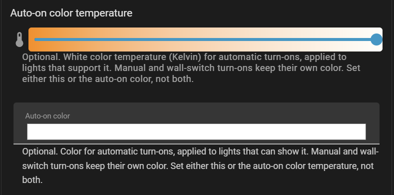

It looks like it’s working fine. Currently, I am in the “night” schedule and the “Inside” settings are used properly. I’ll do more tests tomorrow to confirm that my day settings (“outside”) are used.
Just a (probably) small thing, when configuring the light I selected a color (or light temperature) by mistake while my actual zigbee lamp does not support that (only brightness level).
I got the error message “None of the selected lights can show a color, so a configured color would be ignored. Clear the color fields, or include a light that supports color.” (or the equivalent for white color temperature), but I did not find a way to remove the color/temperature setting, so I was not able to fix this to save the new light and I had to cancel and create it again.
Did I miss something? How can I clear the color/temperature from the configuration panel?
K.
Ha! To be honest I hadn’t thought of that. I assumed Home Assistant handled letting you clear a colour option but it looks like it doesn’t.
I guess I’ll have to think of some nice way to let the user clear some settings without having to cancel and recreate. Good feedback, merci!
