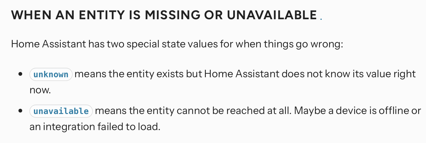

This is not true. You only have to check for unavailable
https://www.home-assistant.io/docs/templating/states/#when-an-entity-is-missing-or-unavailable
It is also easy to change my template to return a list of devices rather than entities, and it would not take 800 lines of code.
You’re not incorrect but you’re missing the point of my main criticism of how HA is currently handling this.

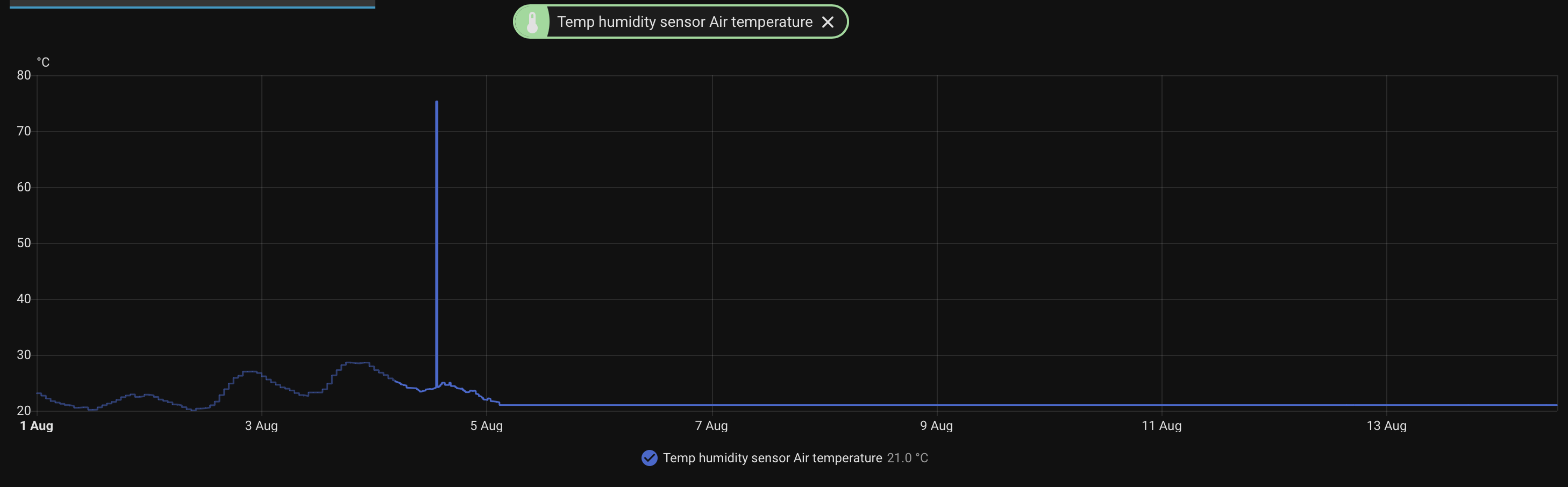

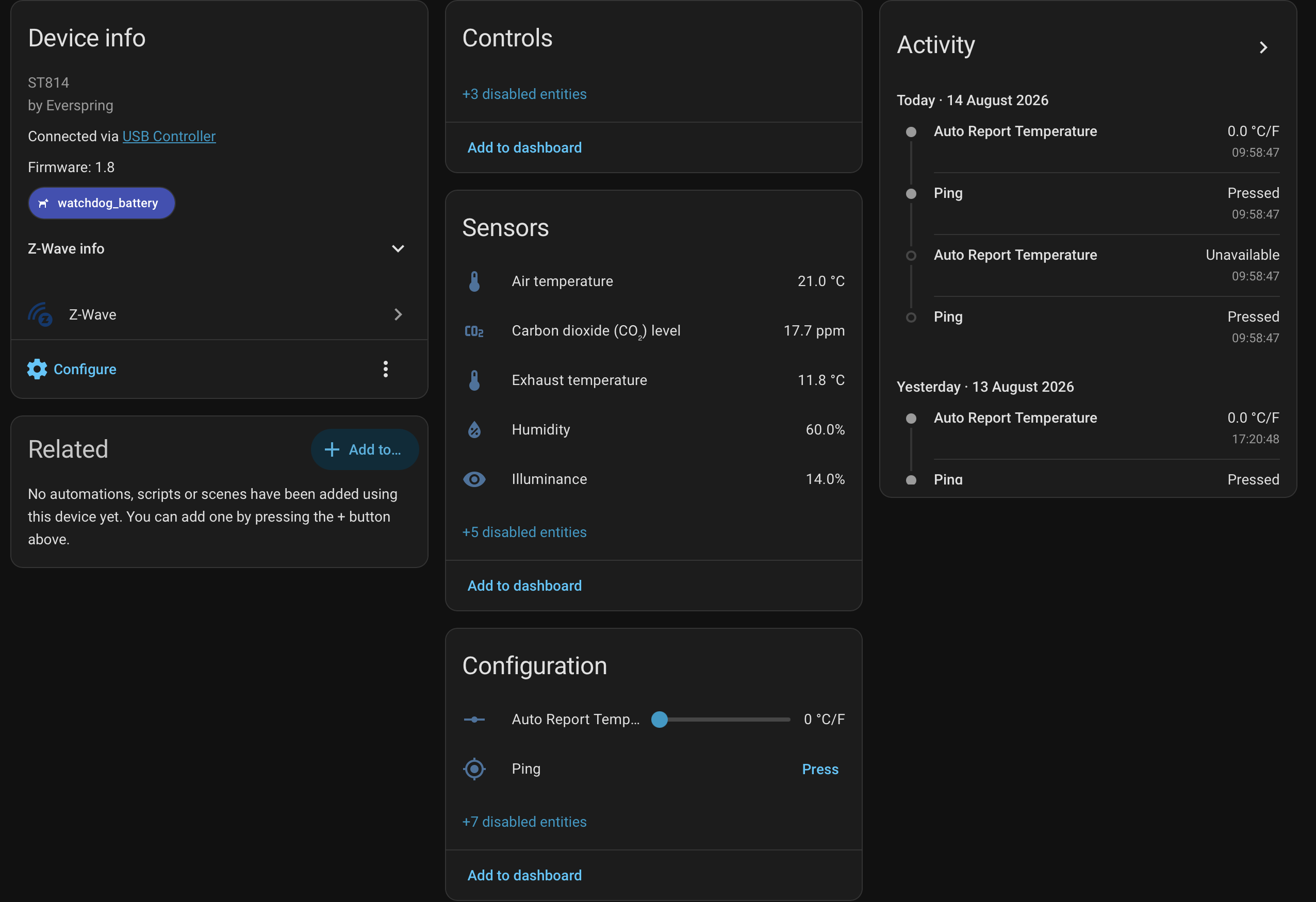

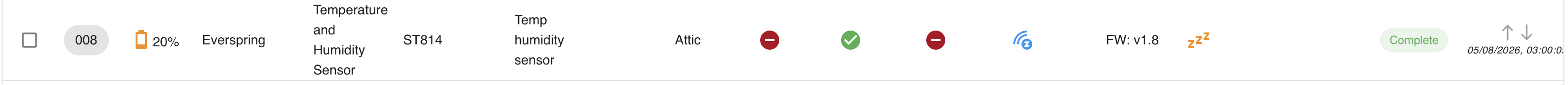

Here is a device that I know has been dead for a week:
This is a zwave, sensor-only battery operated device and Home Assistant thinks it’s perfectly healthy even though the battery died a week ago:
Which is because Home Assistant is trusting the integration which will mostly only ever consider this device asleep rather than dead:
Even though it records that the last activity was a week ago.
And Home Assistant has been repeatedly restarted during that window, and the device has been pinged - but I don’t think the transport will report a failure for a ping to a battery device because of the periodic wake ups. All the payload data entities for this device claim to be not-unavailable.
So could I detect status by checking for ‘unavailable’ on ‘Auto Report Temperature’? Apparently so (based on this activity snapshot), but that is fragile to that entity being renamed or removed, and bespoke config in that many devices won’t have that entity and I’d have to determine an alternative, and if you take a step back - it’s a gap that this is necessary in the first place. The lack of a standardised ‘health’ flag is as if HA left the fetching methodology and normalisation of every sensor to the user instead of encapsulating it so you don’t have to even think about it.

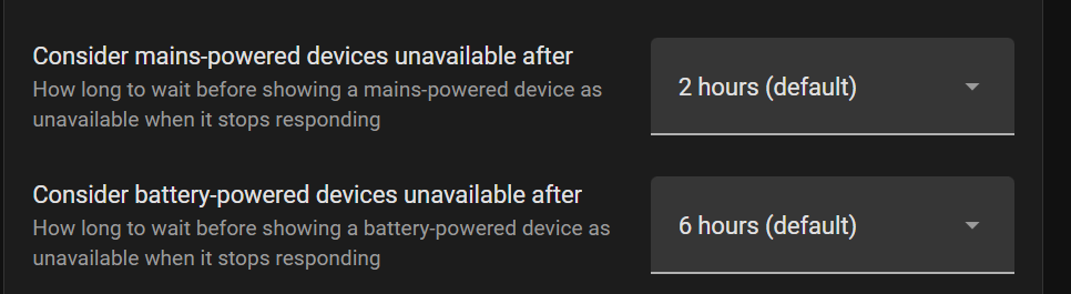

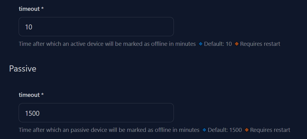

I don’t do zwave but zigbee has two time-out settings that will mark the device unavailable after if it has received no updated from the device, one for battery (1500 minutes by default) and one for mains powered devices (10 minutes by default). Does zwave not have this?

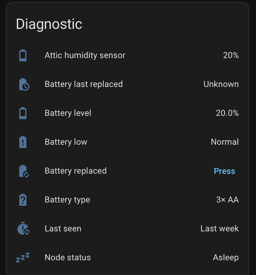

Having played around with this it’s not as simple as I thought - I think the ‘last seen’ value goes ‘unavailable’ if the message is no longer available on the MQTT broker, not simply because the light has been turned off. I have found a device that still has a last seen value in zigbee2mqtt but shows ‘unavailable’ in HA.
This is a manifestation of what I meant by this:
There is no consistent indicator of ‘this device is working’ in Home Assistant. Entities have ‘last_changed’ and ‘last_updated’ attributes, but those are on entities rather than the device and they are from Home Assistant’s perspective, which means that updated timestamps don’t always translate to confirmation that the device is operating. Eg: retained MQTT messages can make stale real-world values look new to Home Assistant.
What HA is displaying makes sense from HA’s perspective - ‘There is no information on this available to me’, but requires an MQTT-specific workaround to use that value for health tracking.

Powered devices also support minimum reporting period in both ZHA & Z2M. There’s no need to configure reporting for their attributes.
Z2M:
ZHA:
