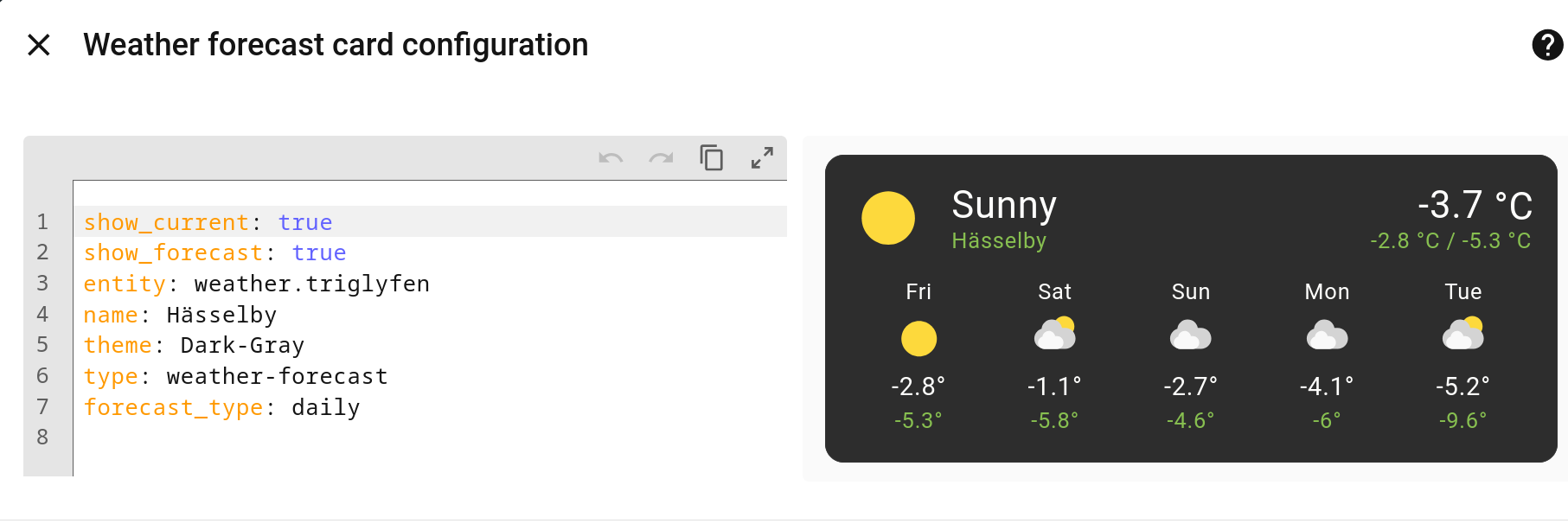

But I have another translation problem.
I use ‘weather forcast card’ and get the english weather state (Sunny) … how can I get swedish (Soligt)
Probably not possible unless you change your language settings to swedish.
OK … good to know
