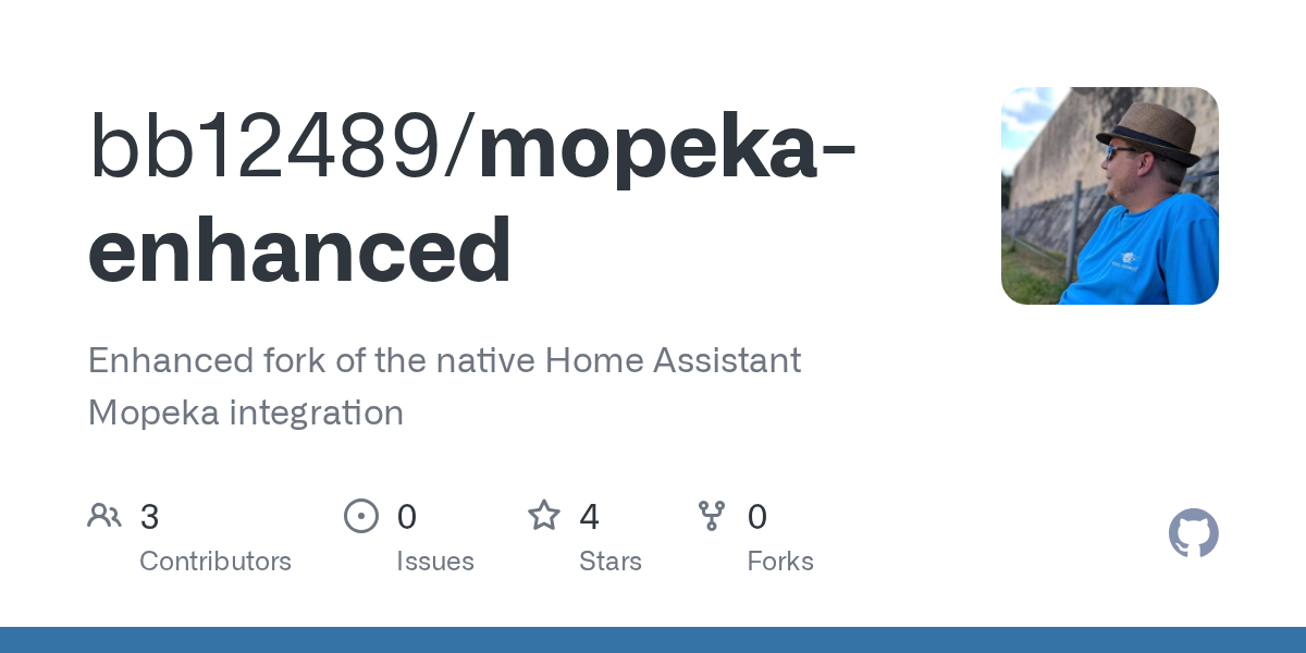

Hello all, and welcome to my first ever custom component release for Home Assistant.
Mopeka Enhanced!
This component is actually an enhancement to the native Mopeka integration in HA core. Anyone who has used Mopeka sensors with the native integration will know just how basic it is, providing only a fluid level reading in inches. This isn’t very useful when we’re used to seeing sensor report in percent or gallons.
The previous solution was to create template sensors to convert inches to percent, but it’s been a pain point for many people throughout the years. I set out to change that. For myself, and others. Here’s what I’ve come up with!

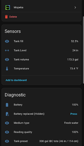

Features

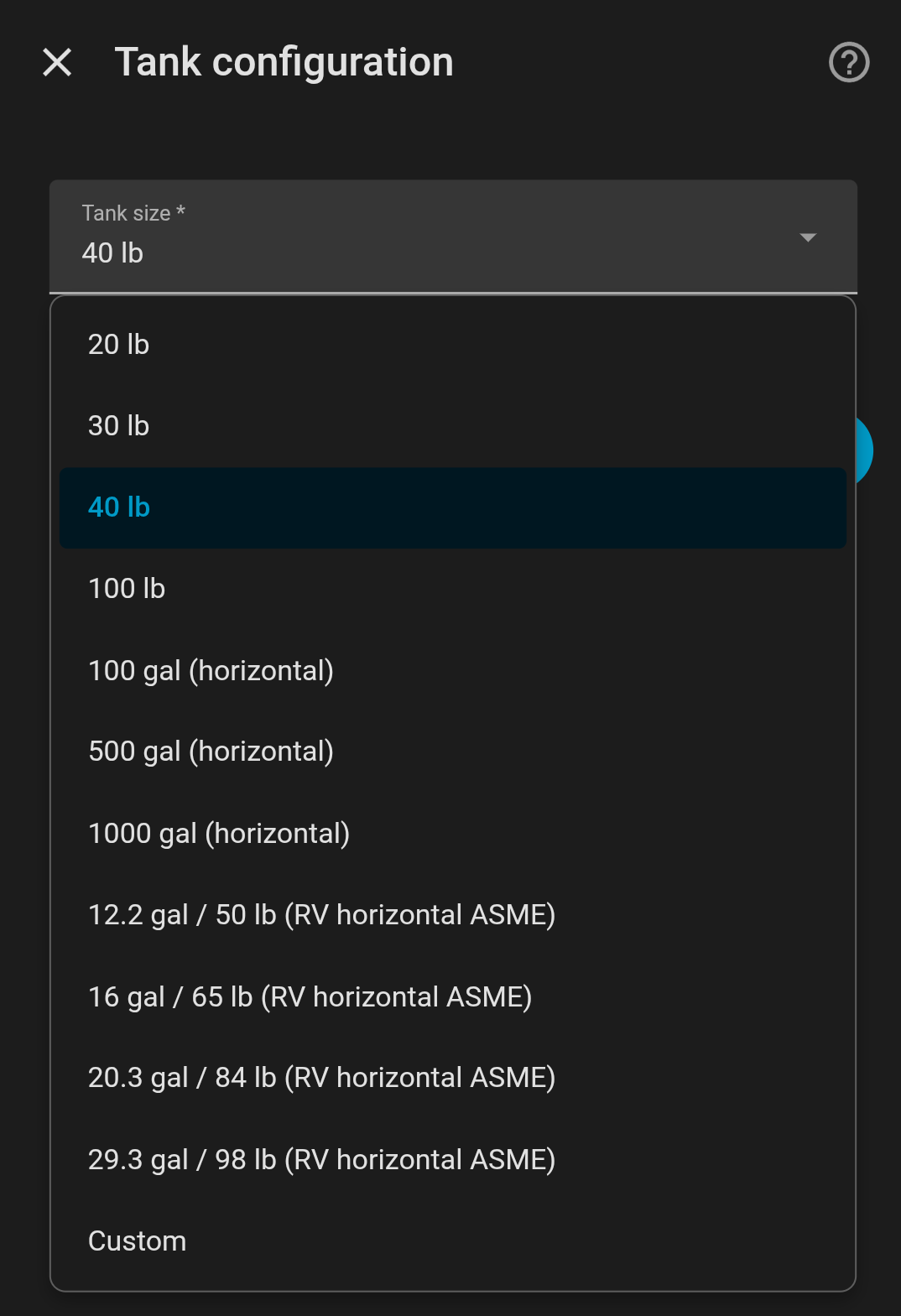

  • Tank presets for horizontal and vertical style propane tanks in gal/lbs (US standard sizes only)

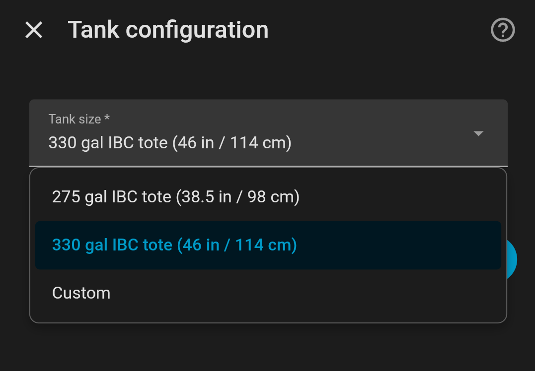

  • Standard IBC tote presets for 275 gallon and 330 gallon sizes (available for all non-propane medium types)

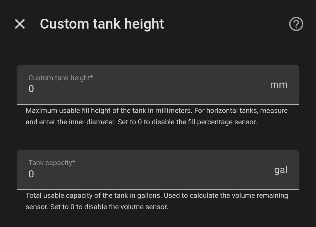

  • Option to define your own custom tank height in millimeters, and tank volume in gallons
  • Automatic detection of top mount sensor models (TD40 and TD200) for correct sensor measurements (top mount sensors read through the air instead of liquid mediums)
  • Updated config flow menu for tank configuration based on medium type selection and device detection (top mount sensors)
  • Added background calculations to better handle horizontal propane tank geometry (hemisphere endcaps)
  • Added two sensors for tank fill (percentage), and tank volume (gallons)
  • Added two diagnostic sensors for Medium type (currently configured medium), and Tank preset (currently configured tank preset)

I’ve also added the option to input Gallons/Kilograms/Liters when selecting custom tank entry. Kilograms is available for custom propane entries, and Liters for all other medium types.

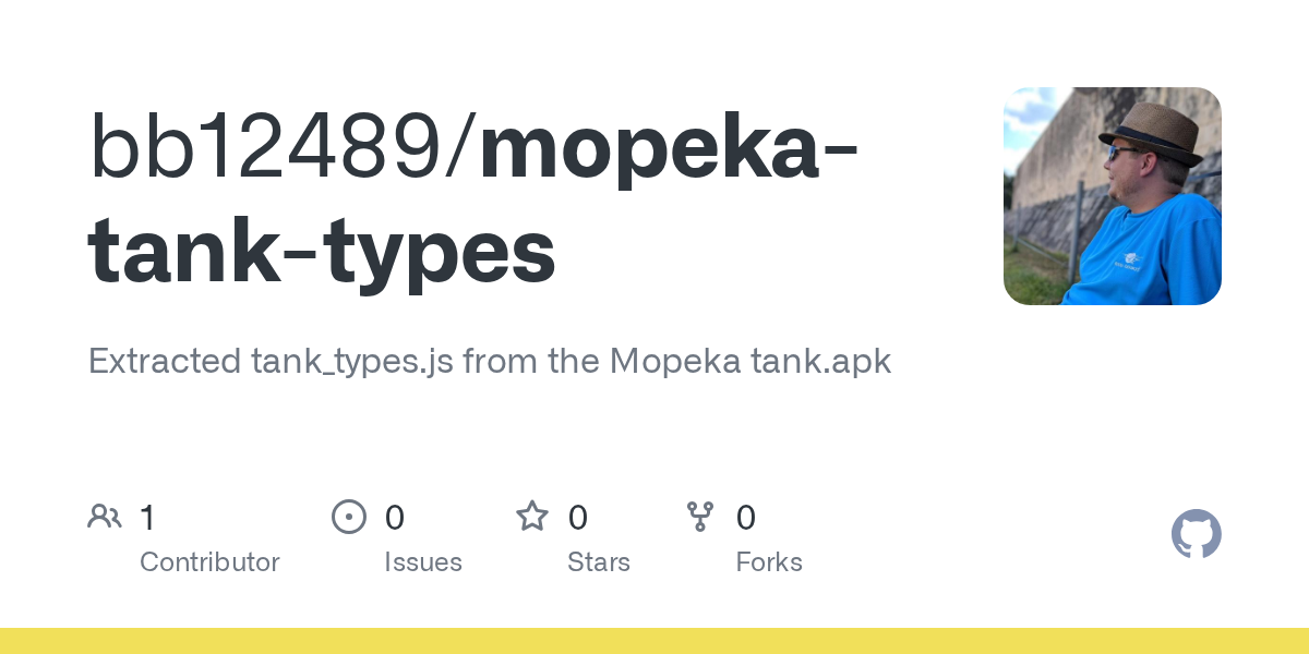

Looks like it wasn’t too hard to extract the tank types from the official Mopeka app. I’ve added all of the US and Euro tank types as defined in the app to the enhanced integration.
There’s a lot of regions listed in their data file for tank types. I may eventually add the rest when I get some time on my hands. See the follow git repo for a breakdown of the tanks types.

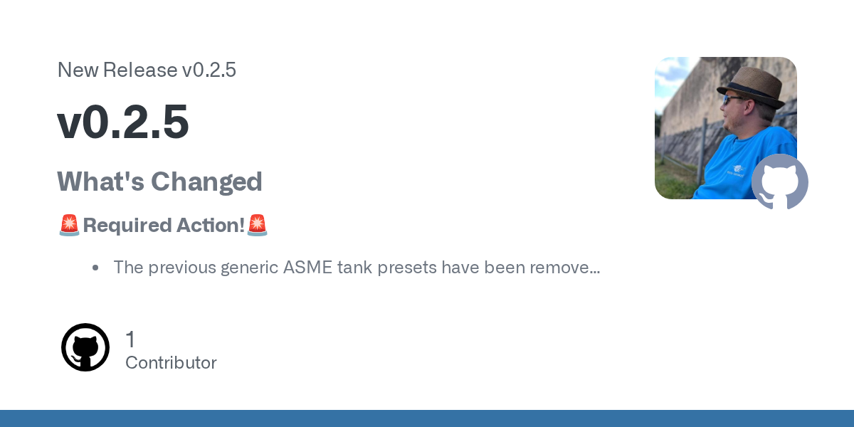

I’ve just released version 0.2.5 that includes 20 new ASME tank presets from Armebe, Flame King, and Manchester. This should cover the majority of RV style horizontal propane tanks in the US region.
