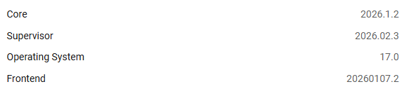

Hello all. Updated Home Assistant OS to the last and get trouble with Mosquitto broker after Mosquitto update to the last.
When trying save the config, get an error
