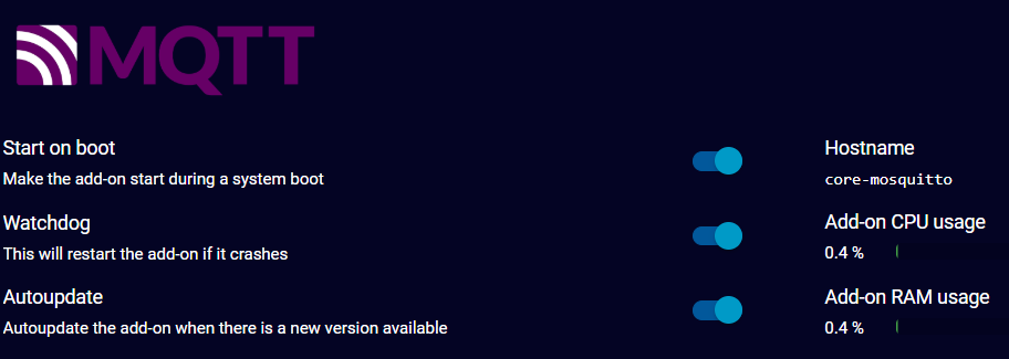

The question is, do you have ‘watchdog’ enabled in the mosquitto configuration so that it auto restarts itself in case of a crash?

yes, i do :slight_smile:
I’d never turn that one as long as anything isn’t running smooth.
As you see you have no benefit from letting mosquitto restart automatically since as long as you didn’t fix the error all it does is try to restart, then stumble across the unfixed error and quits (likely this is the ‘hard kill’ (signal 9) thing followed by the restart.

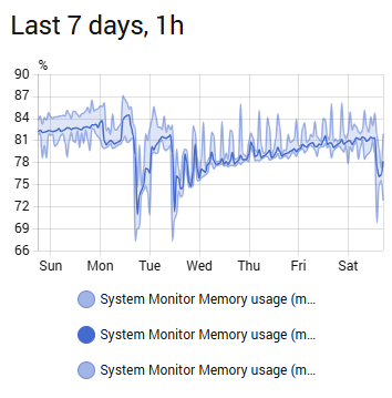

I also suspected it’s a memory issue, but looking on memory overtime, i’m using about 80% of the 1GB on the RPI.
Currently it’s the only add-on running (i have disabled all others few weeks ago: SSH, VLC, Grafana, file-editor and NodeRed)
I think this is the log event saying it killed the addon due to running short of memory.
Time to move to a new device with more memory. In the very short term you could try increasing the swap file size to buy you time till you get a new home for HA
