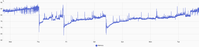

It’s easy to suggest throwing more RAM at the problem, but the add-on is only using 3% of the available RAM. Total RAM usage peaks around 85%.
RAM usage climbs slowly and resets every time Mosquitto crashes and restarts…
So maybe it’s time to look for a memory leak in Mosquitto?

The errors have stopped since I enabled 2GB swap (20% reduction in RAM usage) but I’ve got an RPi5 on the way for a permanent fix.
