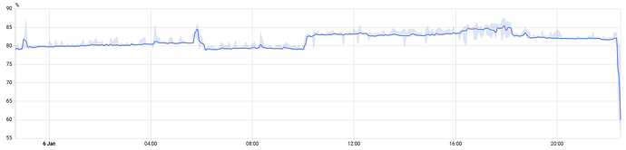

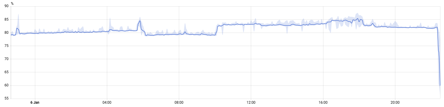

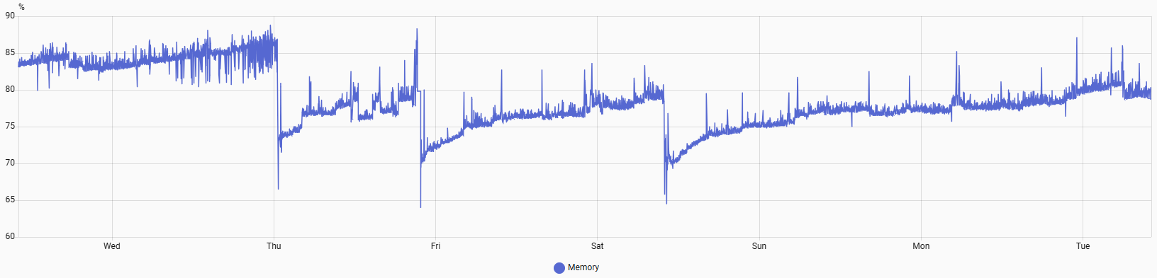

In parallel, I’m seeing creeping increasing RAM usage with a drop back after each Mosquitto crash:
So… does my Mosquitto instance have a memory leak which is causing the crashes? How do I go about troubleshooting that?
