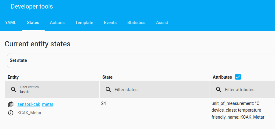

Your KCAK sensor works perfectly here:
I simply added it to the end of my existing command_line sensor.

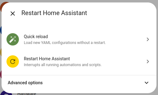

You do need to do a full restart of HA when you add a new integration to your configuration, not just a reload. Choose the lower option:
Thank you @Didgeridrew and @Troon !!
I didn’t know I had to hit “Restart Home Assistant” instead of “Quick Reload” and doing that solved the issue.
It makes sense that it would be needed for a new integration, but, I didn’t realize that’s what I was doing since I wasn’t clicking “Add Integration” from the Integrations page, but it makes sense now.
