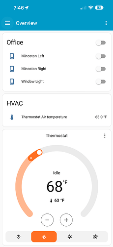

I woke up this morning and the temperature was 63 on the app so it updated but it seems like it’s not updating real time. hmmmm
I wish this had just worked.
It shows idle when it’s on.

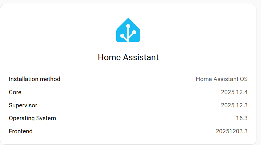

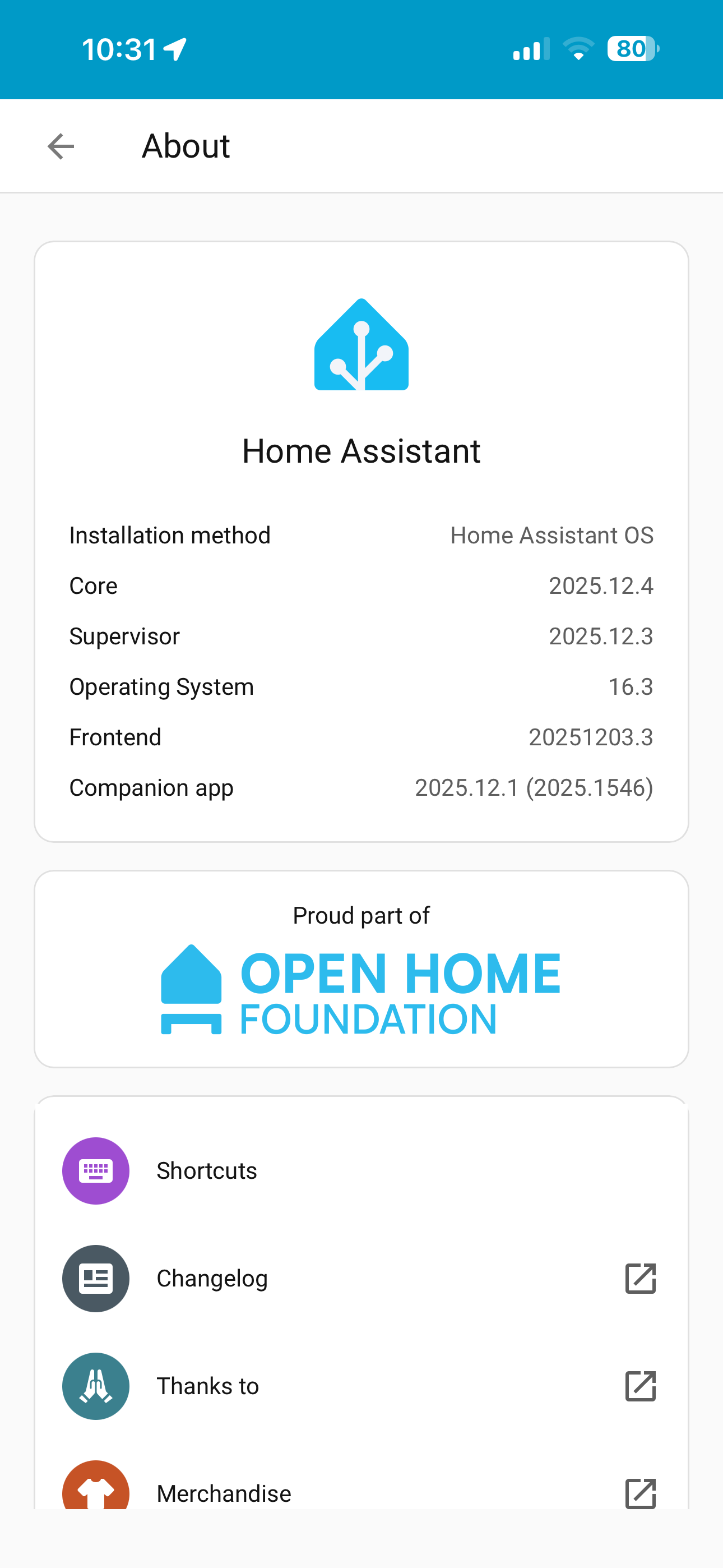

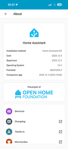

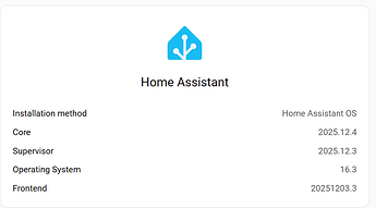

How do i know if I have HAOS? I bought an HA green.
Settings | About
Installation method of Home Assistant OS is HAOS.
