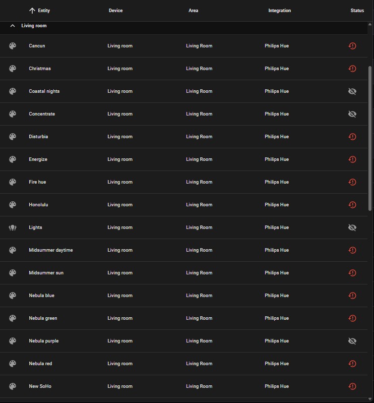

Most of my hue scenes in HA have become unavailable, but strangely not all.
Thee scenes are still in hue, and I can even launch them from HA if I use the hue activate scene, rather than the normal activate scene.
I have restarted HA and the hue bridge several times, restored to my backup taken Tuesday night, recreated a scene in hue to see if setting it up again would mark it as new, and removed and reinstalled the Philips hue integration (after doing that the scenes are no longer there rather than being just unavailable).
Its not clear to me if it is HA or hue that is the cause, it is odd
Any one have any ideas what else I can do?
