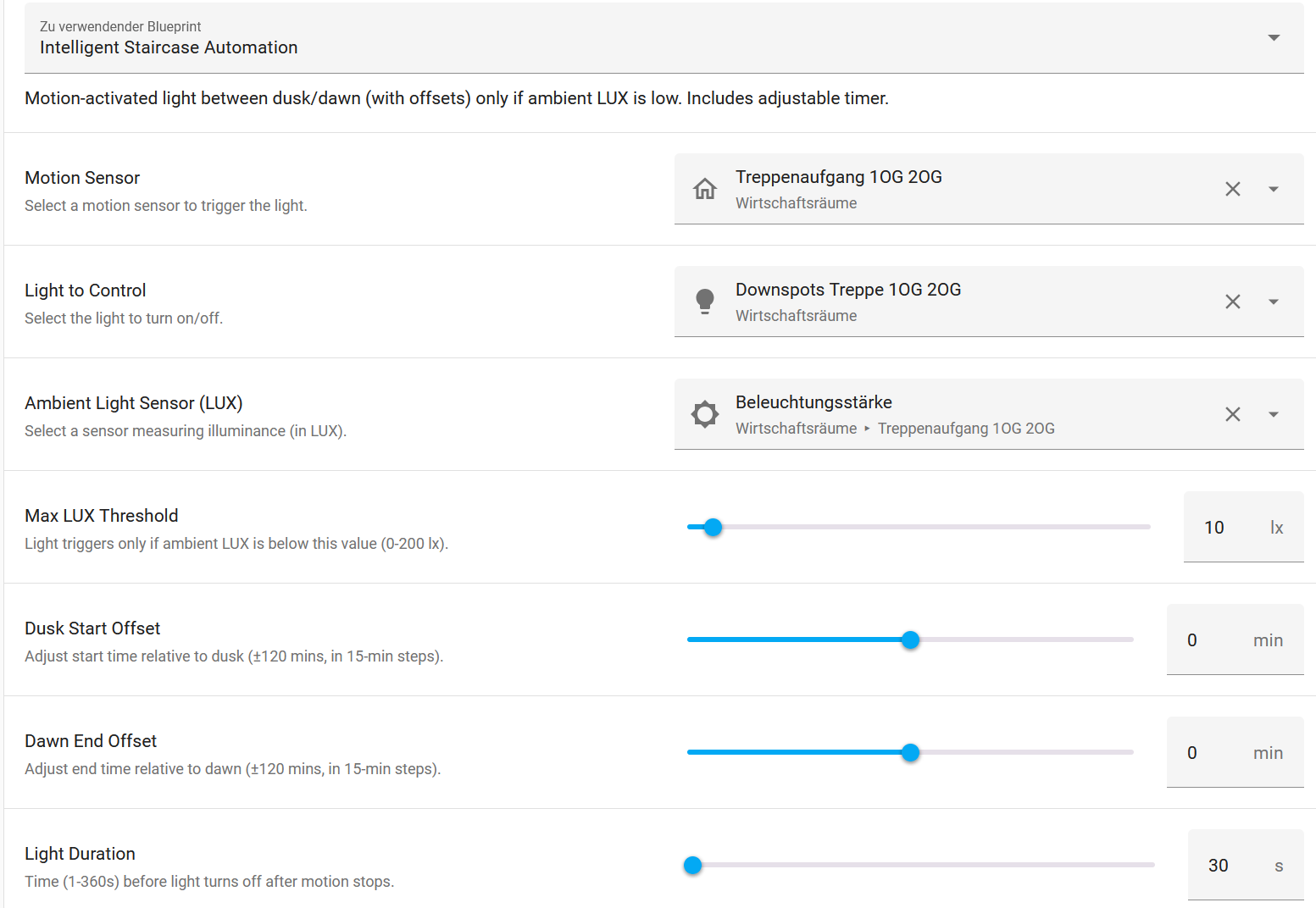

Motion-activated light between dusk/dawn (with offsets) only if ambient LUX is low. Includes adjustable timer
Please comment. Thank you
intelligent_staircase_automation.yaml

I added a screenshot.

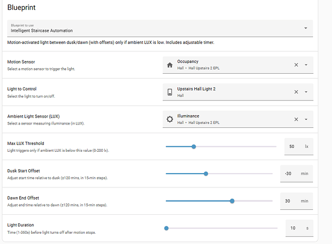

@Beerlesklopfer Hello, thank you for the blueprint, it looked to be exactly what I was looking for, a simple motion controlled light automation without all the complexity of some of the others I have seen.
Have been trying it, but hit a problem and what looks to be some coding issues.
First the problem. My lights are controlled by Shelly smart relays so are switch.xxxxx not light.xxxx control entities. Consequently as the blueprint looks for entity names in the light domain I can’t pick the right control entity.
However I was able to edit the automation config to use the right switch entity name, so if this works, then this will be a workaround. But would be better if the picker can choose from both switch and light domain:
alias: Upstairs Hall Light 2 Motion
description: ""
use_blueprint:
  path: Beerlesklopfer/intelligent_staircase_automation.yaml
  input:
    motion_sensor: binary_sensor.hall_upstairs_2_epl_occupancy
    light_entity: switch.upstairs_hall_light_2
    lux_sensor: sensor.hall_upstairs_2_epl_illuminance
    dusk_offset: -30
    dawn_offset: 30
    light_duration: 10

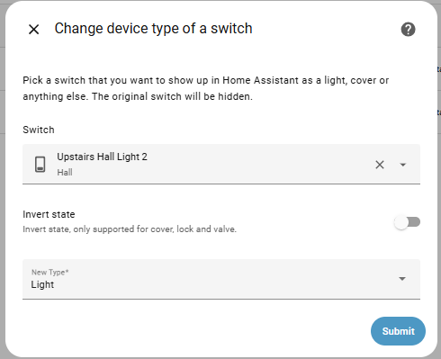

Edit: running the automation manually, my use of a switch entity didn’t work as the automation calls light.turn_on / light.turn_off so unless it can be made more generic, I’m out of luck with this.
Edit 2: turns out there is a way round this, create a helper of type ‘change device type of a switch’ to make it a light domain entity, and job job, when I put the new light entity into the automation it works :+1:

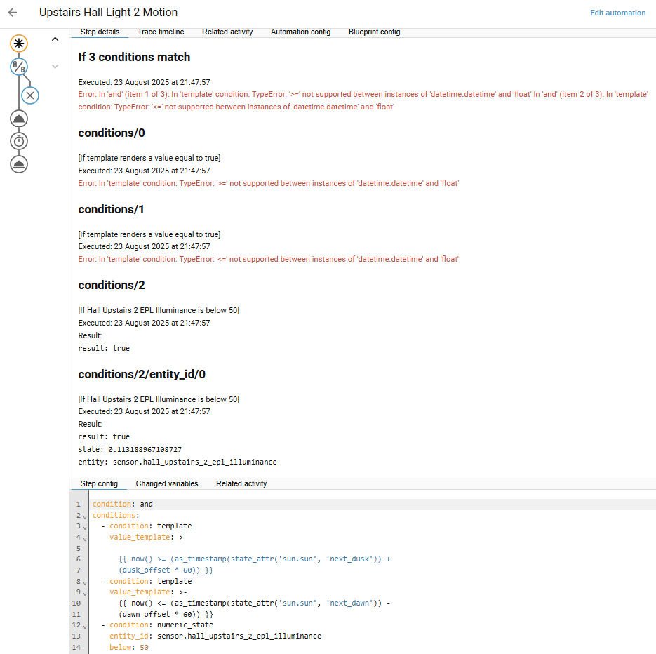

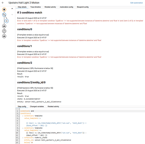

Now the bug. When the automation is triggered by the motion sensor and I look at the automation trace I can see that the automation fails with what appear to be data type conversion errors:
now() returns a date/time object eg 2025-08-23 22:05:43.496542+01:00
and
as_timestamp(state_attr(‘sun.sun’, ‘next_dusk’)) returns a Unix epoch time (time in seconds since 1/1/1970) - a float value
so these are not directly comparable
The template should be using
as_timestamp(now())
