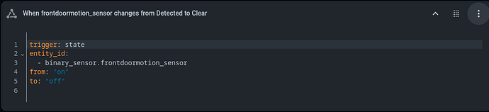

Just FYI:
On the dashboard it will show detected and clear (as the sensor has class motion).
But under the hood (yaml), the motion sensor is ‘just’ another binary sensor
and will use on and off
So while the visual editor shows:
It’s yaml will show:
