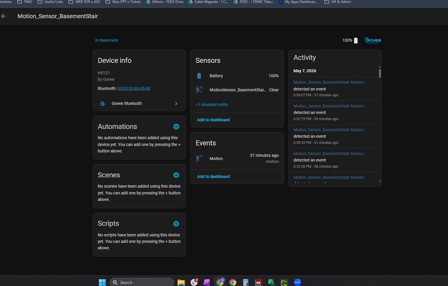

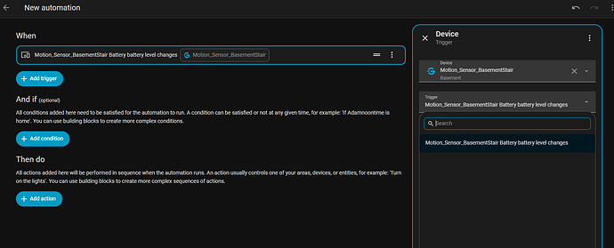

I just purchased a few sensors from Govee (motion sensors and window/door). The bluetooth integration is working great, they show up on the dashboard and report motion and battery life on the device info. However, the motion is showing up as event. When I try to set up an automation, it won't let me select the sensor as a trigger for my lights or whatever else. The only option is battery state.
Is there a work around that I can do, or something I am missing here? I have searched and searched.
The best information that i have come across is to make a template, however I am still having trouble or maybe I don't know what I am doing, however, I am willing to learn.

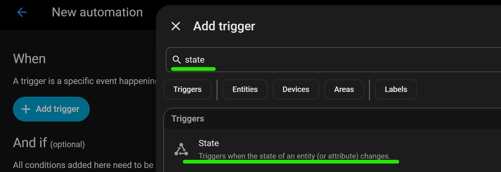

Use a State trigger, not a Device trigger.
I can't seem to find an example. When I try an automation, there is no state trigger available.

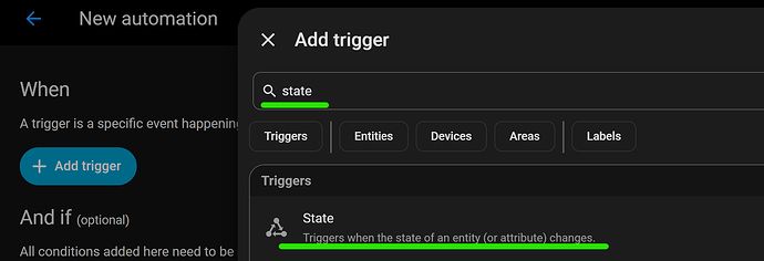

type state in the search box for the trigger
LiQuid_cOOled has showed how to find them in the Automaiton Editor, more information can be found in the docs:
Thank you much. I guess I got stuck in a rabbit hole of old examples. I thought I had to write custom YAML templates to create binary sensor's.
This worked and was extremely easy!!!.

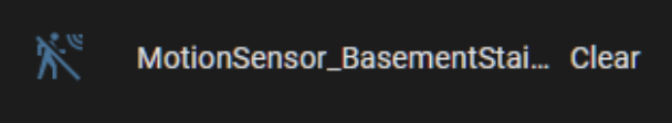

Isn't this your state entity here?
What does that entity show in dev tools when there's motion or no motion?
I think you missed this caveat :down_arrow:
Ah, I was confused by the "instead" as it seemed from the image like the integration created both the binary sensor entity and an event entity. What's the sensor for?

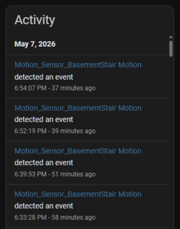

I agree it seem like that should be the case.... But, in the image there aren't any events in the Activity log for the sensor... just for the event entity.
Motion in the OP's basement and your instincts are on point. A binary sensor would be the norm.
The device is not creating the normal Occupancy entity and appears to only log an event
My gut tells me it's integration via BT is the issue!
