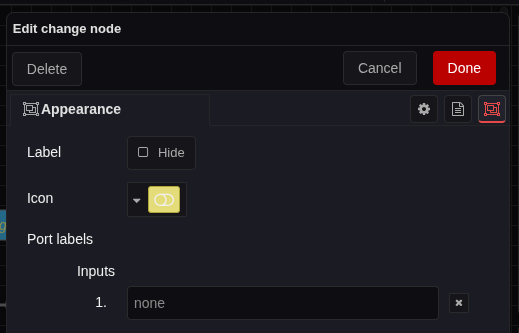

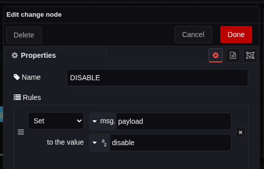

It uses some node icons i've not seen before - the green little ones, what are they?
They are ordinary change nodes (with a custom icon though :wink: )
