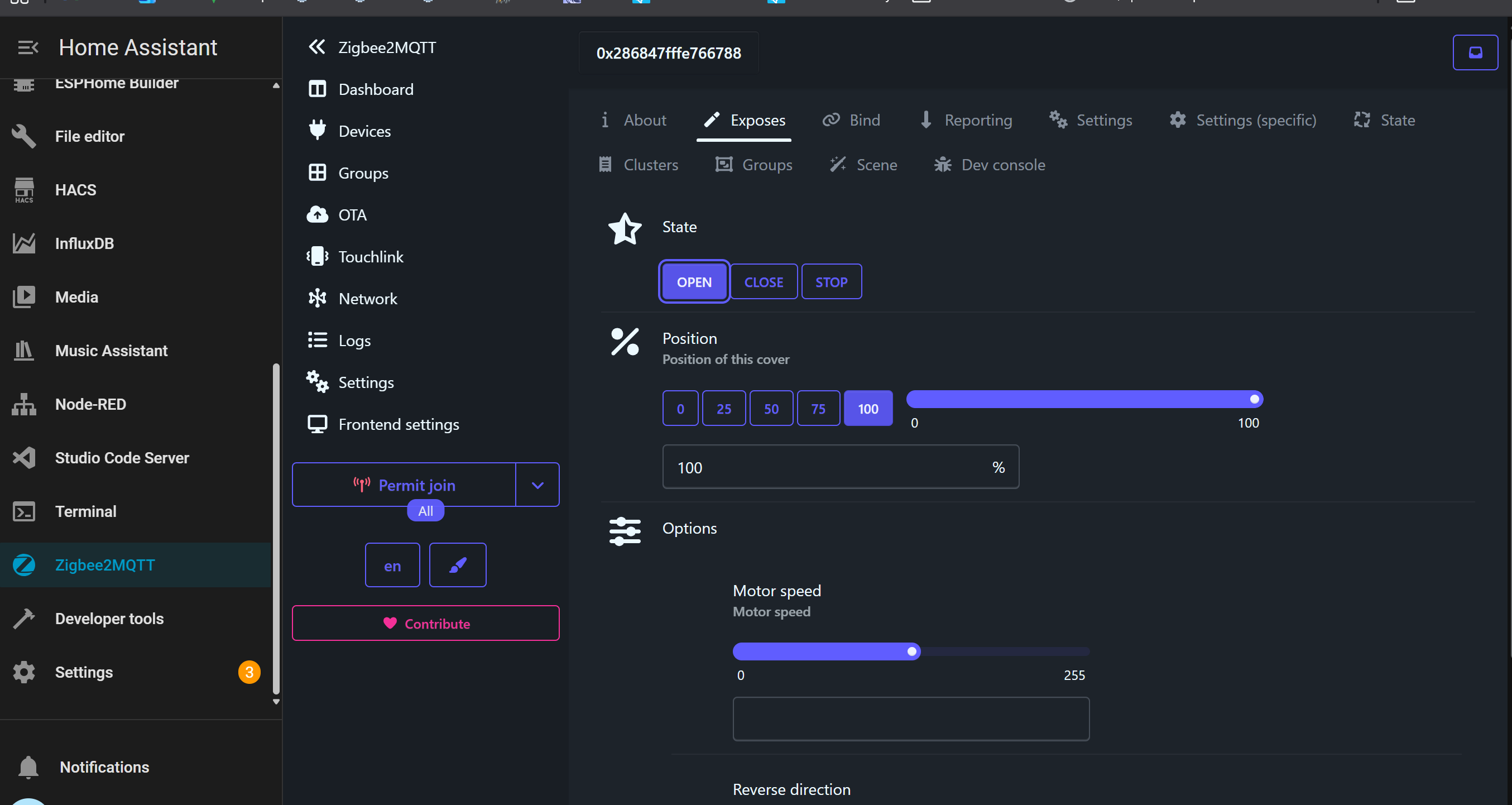

In Zigbee2MQTT, click permit join.

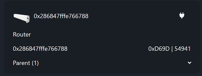

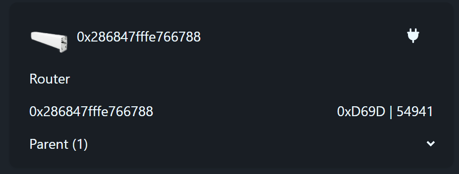

On the Dooya DC1545R, press the button for about 5ish seconds so it flashes fast (the green light is also a button)
It immediatley showed up in Zigbee2MQTT and was controllable in there as well as in HASS.
Position setting works fine too. Response is basically instant. No need for Tuya App.
Now I need to buy a full set of DC1545R’s which will be a fair bit of money as we have ~30 blinds. That will save me trying to fab up stuff to drive it serially although that is a stretch goal as in future I want to be able to power off the motors when not in use to save that idle power.
I would say that the DC1545R shows up as a router; I understand that is the name for a ‘mesh extender’ so all the DC1545Rs that will be around the house should ensure good Zigbee coverage.
