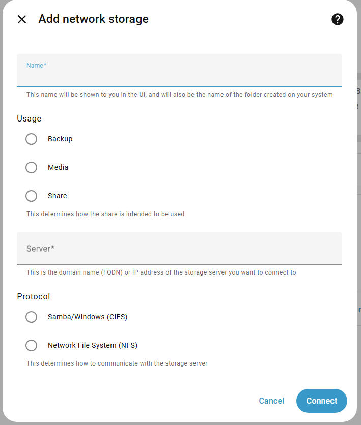

You can’t. In Settings > System > Storage you can create a symbolic link to network disks for your config/Backup, config/Media or config/Share.

I finally solved the problem by configuring Samba on Proxmox. It’s quick and easy.
