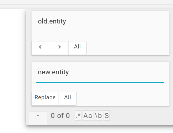

  • Switch the probe to the other Shelly & take note of the new entity name.
  • Back up your automations.yaml file, just in case.
  • Open it with File Editor Addon or notepad if you have Samba Addon installed.
  • Click once inside the file contents, then press Ctrl+H
  • In the popup, enter the old entity name & the new entity name > click Replace:
  • Save the file
  • Go to Developer Tools & click Check Config. If ok, Click Automations on that same page under YAML configuration reloading.
You can also do the above steps if you open each affected automation in yaml mode (use Ctrl+F instead of Ctrl+H).
It’s safer since you only change 1 automation at a time & doesn’t require manual reloading, but it’s more tedious and you might miss one of the affected automations.

I did it like you said and it worked nice, thansk so much again!
