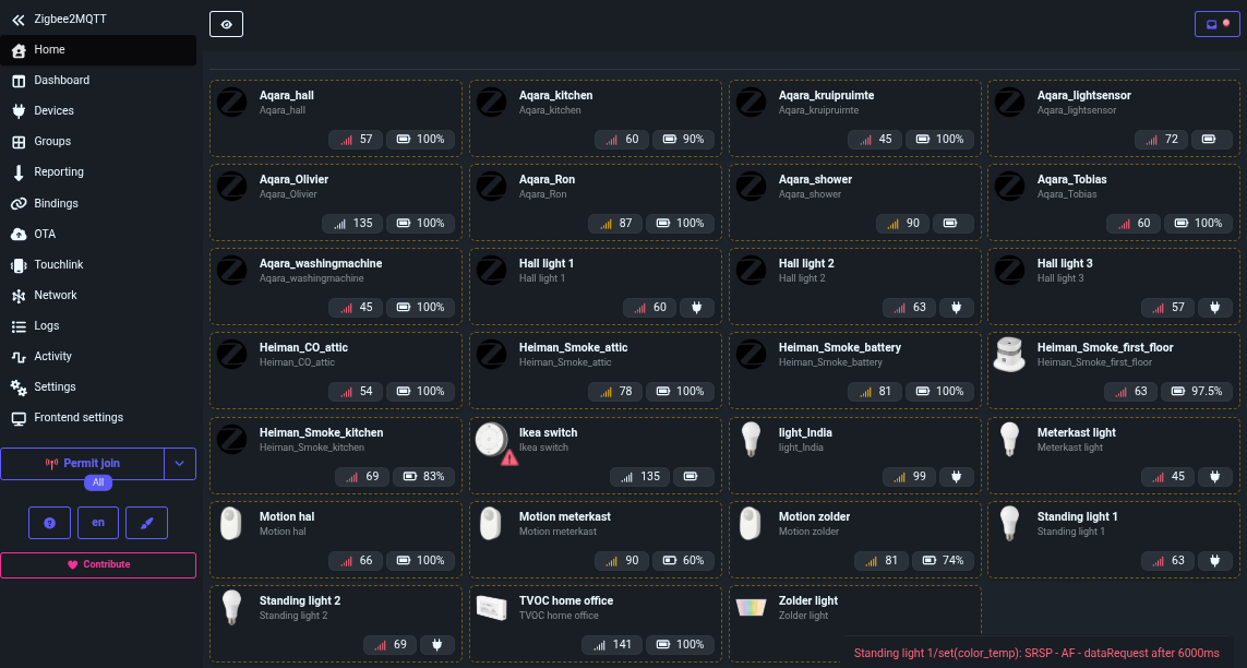

Ever since I have moved from a pi4 to pi5 and from zigbee to zigbee2mqtt I’m having issues with scenes and devices. No zigbee device seems to be working reliable anymore. I guess I must be doing something wrong but I can’t figure out what is going on.
Devices keep being disabled and the lights refuse to work at all. I have removed them and joined them back again. When a simple automation is to run to turn the lights on at a specific time the message is sent but the lights refuse to do anything. Even when I toggle the lights from withing zigbee2mqtt noting happens. When I try to select the mqtt variants it gives the same result. I can select the mqtt light but I can’t toggle anything.

    If toggling a light inside the Z2M frontend does nothing, Home Assistant isn’t the issue yet – the radio link is. Two classics after a Pi 5 move: the stick sits directly in a USB 3 port (USB 3 noise sits right on 2.4 GHz and kills Zigbee range – put it on a USB 2.0 extension cable, 50 cm or so), and ZHA still holding on to the same stick. Make sure the ZHA integration is deleted, not just disabled, before Z2M owns the coordinator. The Z2M log usually tells you which one it is (look for “MAC channel access failure” / “NO_ROUTE” errors vs. adapter connection errors).
