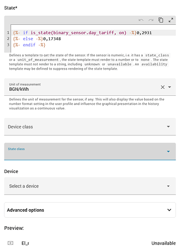

It shows as unavailable:
Compare the code in your first post with that in your screenshot.
Hint: it looks like you’ve omitted the quotation marks around the binary sensor entity_id in the is_state function. This function won’t return a value without them, hence ‘unavailable’. You also need quotes around the state value: 'on'.
You’ve also changed the decimal separator from a point to a comma. Not sure if that is important for how you intend to use this sensor though.
As Chris has pointed out above, you are missing quotes around the entity ID and state args in your is_state() function. Without those quotes Jinja interprets binary_sensor.day_tariff as a variable instead of a string, and you haven’t defined a value for that variable… which will cause an error. IIRC, on will be treated as a boolean, but the state arg expects a string, so that will cause a different error.

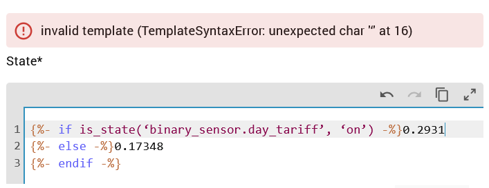

You are both right, I removed the quote marks as there was warning for an error:
I’ve now typed them back in and there is no warning. It seems formatting issue with the originally copied string.
