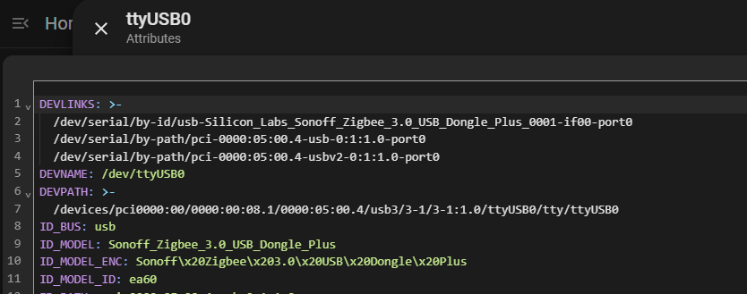

Under configuration → Serial: is that correct?
Compare with
I took the first line
Then
But this is still generates the same message.
Dongle is ZBDongle-P
what if you put /dev/ttyUSB0 in serial → port
Did you check if it’s the right port
on your new system?
this is all on my new system.

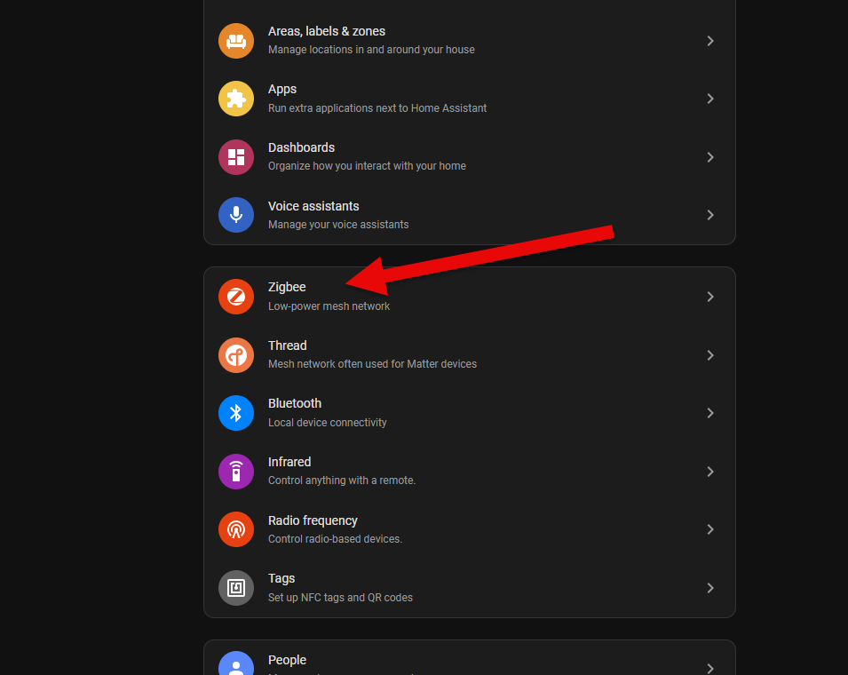

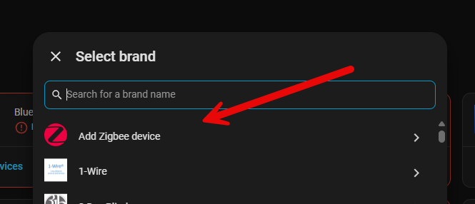

The only big thing I tried was in devices pres “Add Zigbee Controler” it then went to a spinning wheel. But after trying that the Z2M started and is running now. It still spins. But 99% of my automations have started to work again from motion etc
What is that screenshot?
Are you using ZHA as well as Z2M?!?
when you go to settings there is now a ZIGBEE item in the menu next to THREAD etc
But I am using Z2M not ZHA
Are you talking about
Open your Home Assistant instance and show your settings menu.
After pressing this from DEVICE page.
That is ZHA imho.

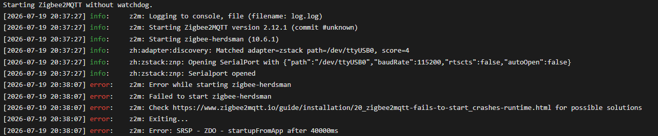

Check
Open your Home Assistant instance and show your integrations.
There you go: that’s the reason why your Z2M is not working.
You can’t have both with the same coordinator!
