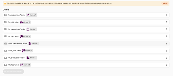

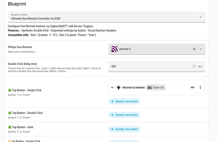

I used to see this nice blueprint-based formatting:
and the same one (or very close) once converted to a non-ui automation:
I dont mind it being readonly, but I see no reason why it should lose the blueprint formatting ? Is this normal ? I see no error on load, the blueprint is still here in the correct location (I think).

possibly related: Getting "This automation cannot be edited from the UI, because it is not stored in the automations.yaml file, or doesn't have an ID." when opening automation
It’s now just showing the blueprint output, which is the automation and is expected.
thanks for confirming it’s expected. Since the only difference with the content in automation.yaml is that it’s now in a read-only file, is there hope to see the same interface as in the original automation (even if it’s read-onlu) ? I found it more understanble/parsable. I think I read in other posts that HA wouldn’t because someone might alter the yaml content but I believe blueprint standardize the output so if it fails the check the display could revert to the current “raw” mode and otherwise (ie, successful parsing) show the nice blueprint view.
