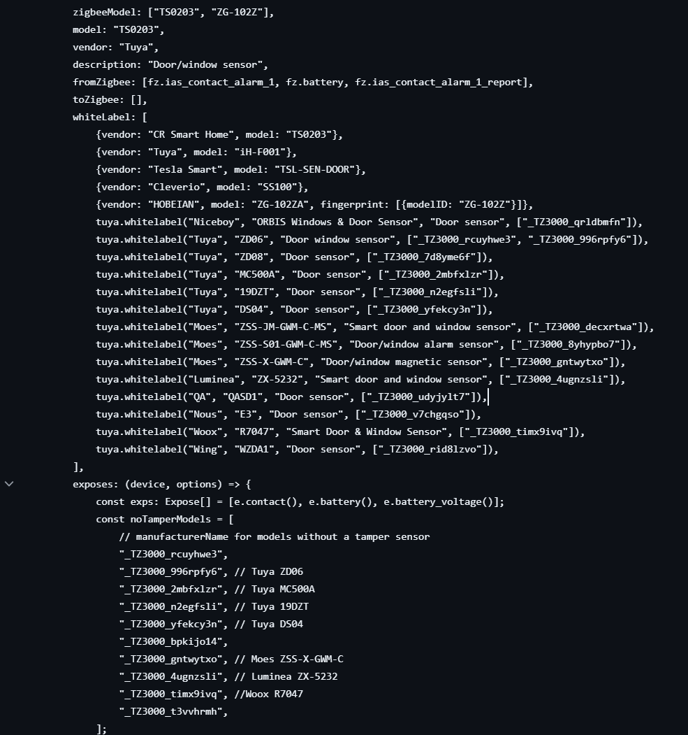

Correct, even in Z2M it’s a bit of a cat & mouse game because Tuya use different model names for essentially the same sensor.
The below is just a random door/window sensor I found on Z2M. Look at how many different (known) model names are possible for essentially the same device:
