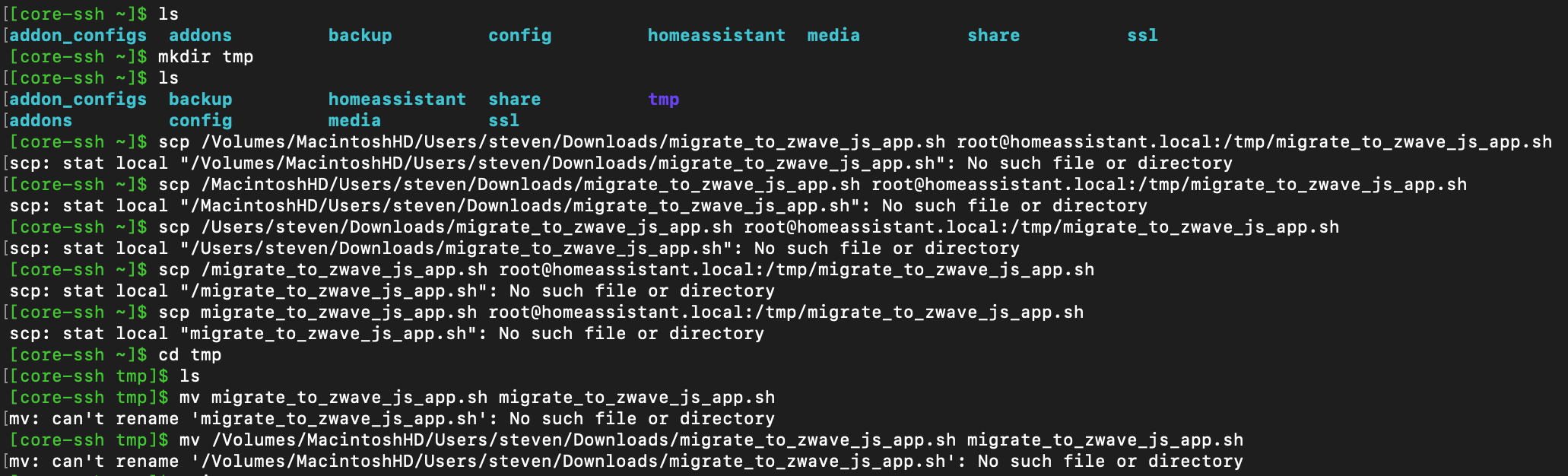

I need to migrate my failing Z-wave stick but first I need to change back to Z-wave JS. I’m trying to follow the instructions but I have not been able to copy the script and backup from my mac to home assistant. I’ve tried scp and mv but my command line knowledge is non-existent and I can’t figure out what I’m doing wrong. Any assistance would be appreciated!

You appear to be trying to access a file from your Mac while you’re in a Home Assistant app, which isn’t going to work. You don’t need scp either, it’s never mentioned in the migration guide in fact.
Well, the instructions in the guide are slightly wrong so that doesn’t help. You can just download the migration script directly from the core-ssh add-on with these commands:
cd /tmp
wget 'https://gist.github.com/AlCalzone/eb0947a39a3ff91c053f259f0ac4efc3/raw/69494c1671a04ba81b5ffb6060037ccf02a57fb2/migrate_to_zwave_js_app.sh'
chmod +x migrate_to_zwave_js_app.sh
Then follow the rest of the guide.

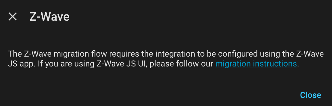

As for the why, I need to migrate my z-wave adapter because my current one is physically damaged. When using Migrate Adapter it says that it needs to be done in JS, not JS UI.

The migration flow is a “wizard” to guide you through NVM backup and restore from one controller to another. I believe this requires a working controller, so if your current one is damaged I don’t think migration is an option (at least I presume, I haven’t done it). In that case, hopefully you already have the NVM backup.
If you have an NVM backup from the old controller, you can go to HA Settings → Z-Wave → Restore from backup (which is the option above “Migrate adapter”). This will let you manually upload and apply an NVM backup. This works even if the ZUI community app is being used, so you don’t have to switch yet if you don’t want to.
