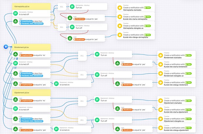

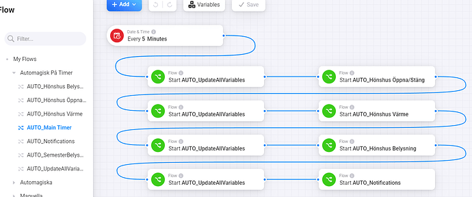

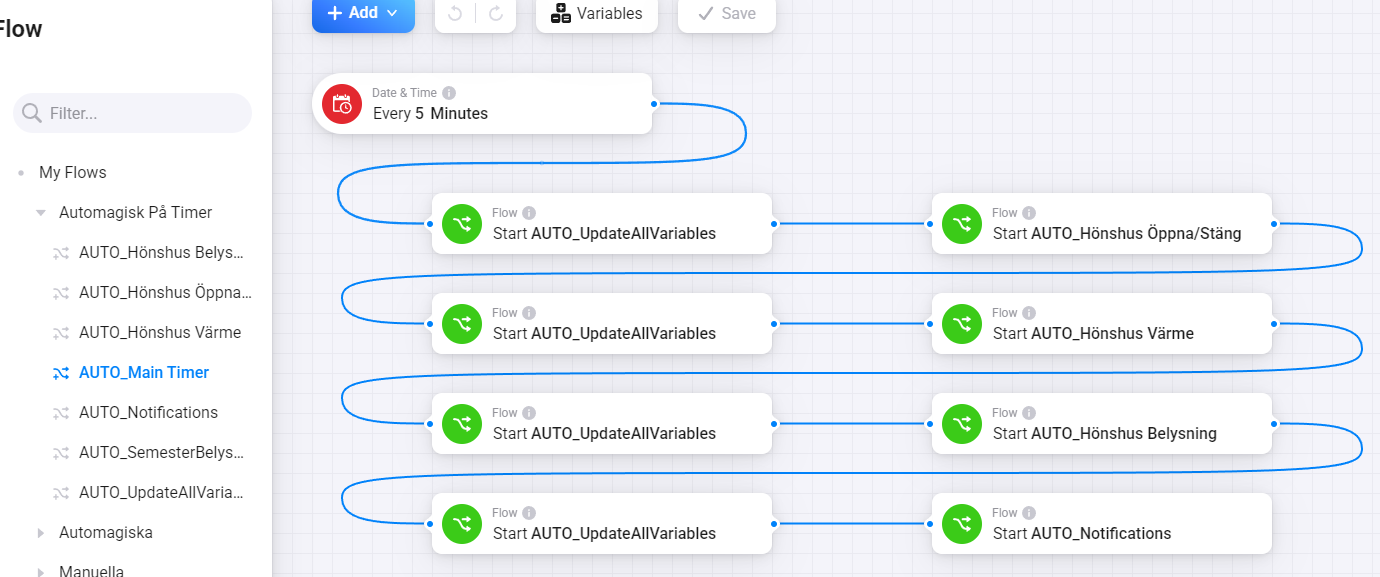

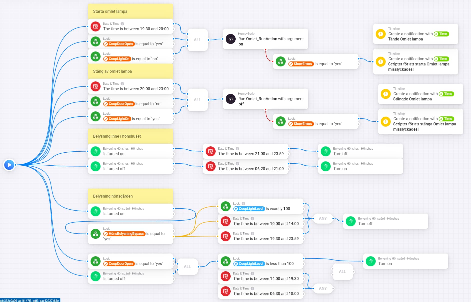

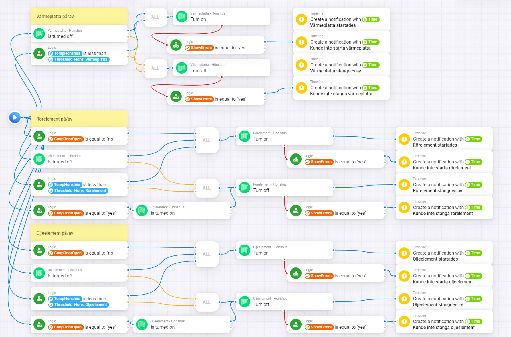

In Homey Pro I get a very nice view of all this like this, would be great if there was something similar (with similar i mean the way you can easily follow the logic, the code above is even easier for me since i’m used to code in C++, YAML is not really intuitive for my old coder brain)
Main loop
Heating (The “AUTO_Hönshus_Värme” trigger in the main loop)
Lights (The “AUTO_Hönshus_Belysning” trigger in the main loop)
