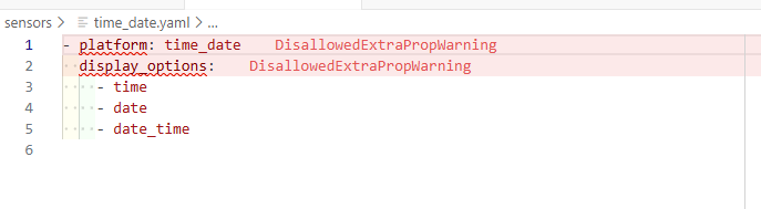

I first created sensors folder and there date_time.yaml file and then tried to add this is my configuration yaml: sensor: !include_dir_merge_list sensors/
but no matter what I tried date_time.yaml was always giving some kind of error. I tried different file formats like

If you want to split your sensors, you should do something like:
then your first form will work in a sensors/date_time.yaml file

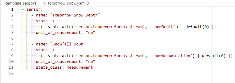

So currently my configuration.yaml has these both (this patter warning are somehow related to vs code config, found this by googling around.)
and for both, I have folders with my yaml files there
Everything is working just fine in the template_sensors folder

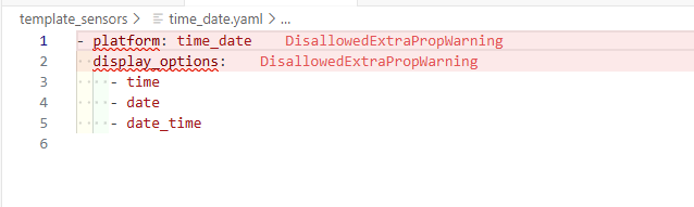

but platform sensors in the “sensors” folder are giving the red
Same things happens if try to move the file from “sensors” to “template_sensors”
Not sure if doing something totally wrong by splitting them like this or am I not just understanding something here because this is fairly new topic for me.
Ignore “errors” from vscode. The HA extension is on life-support, if even that.
Show us the errors from the HA log, if any.
Yeah, seems like so because I checked and restarted my HA and I can see those sensors just fine now… and nothing can be found from HA logs related to these after booting
