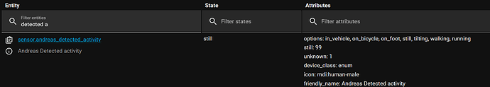

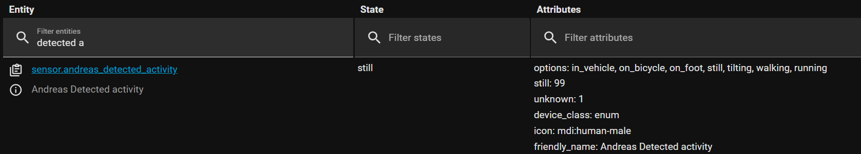

wow, where can i find this sensor?
Companion app.
You need to enable the sensor.
Not sure if it exists in iOS
