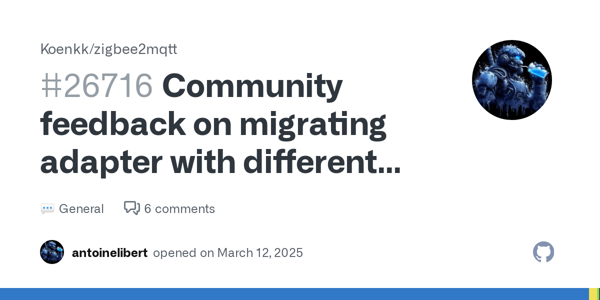

That is not necessarily true. It depends on the adapter type and the chip in each coordinator.
This is a good reference
