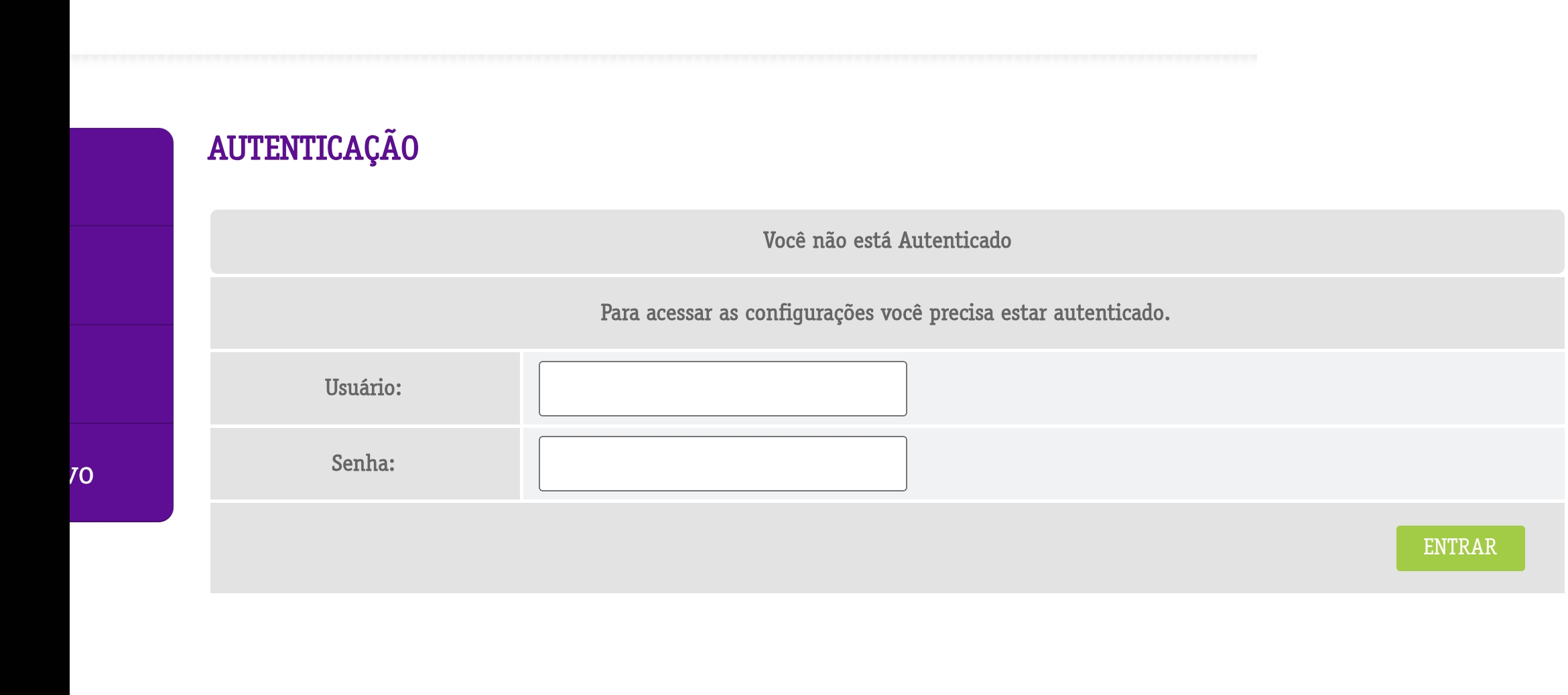

Thanks for the integration! in Brazil we also use this router Askey RTF8115VW. But cannot connect with the integrarion, maybe could be because here need userid and password. Attached image.
