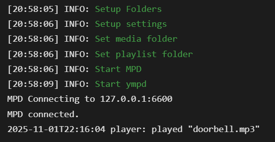

MPD is installed and running successfully. Log is clean and no error in the the logs.
As you see in the log, I was able to use the yMPD on the sidebar and successfully play mp3 file on the speaker connected to Pi 4.

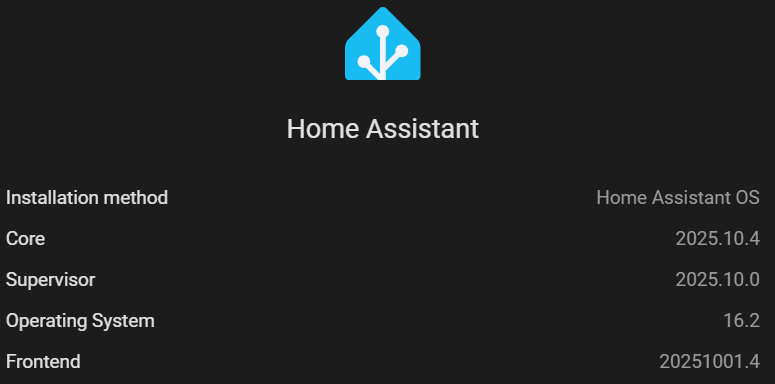

Below is my HA info

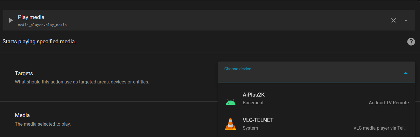

As you see I have VLC via Telnet installed on HA because could not get MPD showing up. And you may ask why aren’t you using the VLC. My problem with VLC is that when I try play a file using automation or Developer tool. It plays only the first file I played to test it. It will not play any other files. When I pass the file it keep play the old file. It seems it has cached the file and I can clean the cache. I clean use the clean playlist (which I don’t have any) but nothing changes.

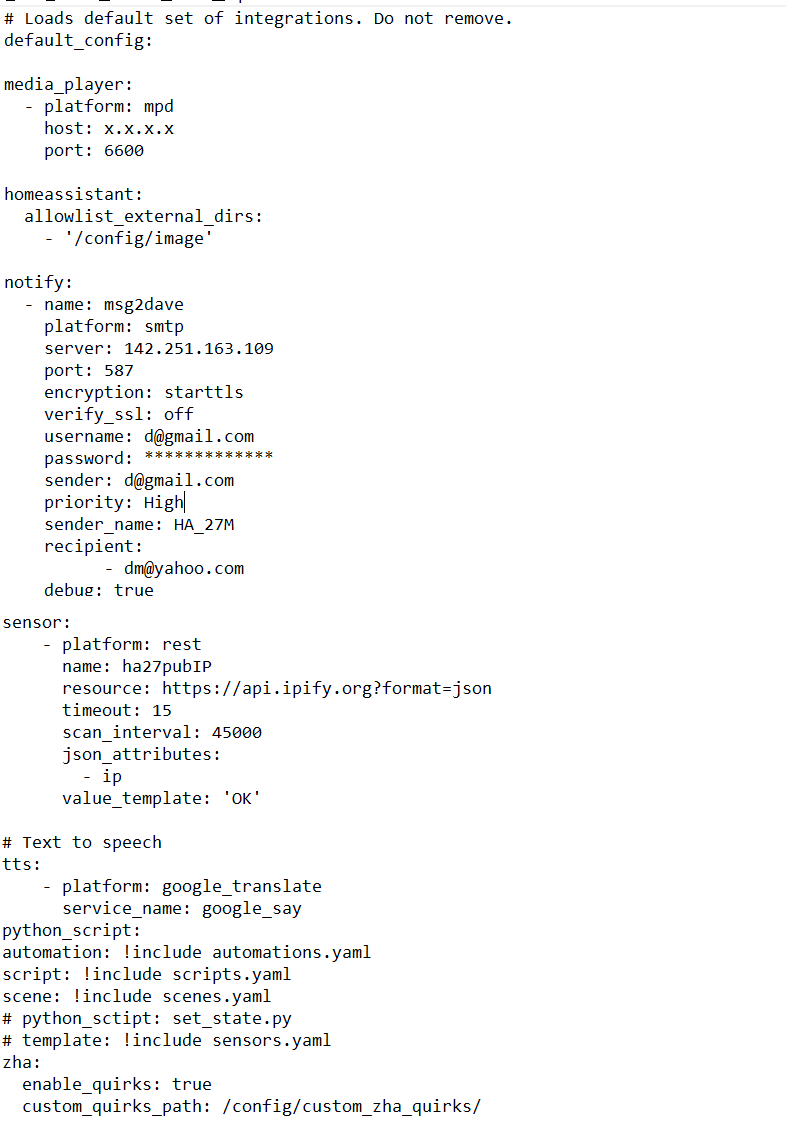

That sounds like you have something added to your configuration.yanl and the integration have a GUI setup instead.
Below is my Configuration file. It does not have much
You probably need to remove the media_player entry with the 3 lines below it, then restart your HA and go to the settings and add the integration there.
correct, MPD is no longer setup via Yaml in the configuration file, but via the UI, see Music Player Daemon (MPD) - Home Assistant

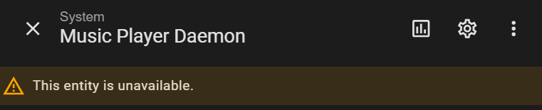

I am still getting the following error:
media_player.music_player_daemon unavailable

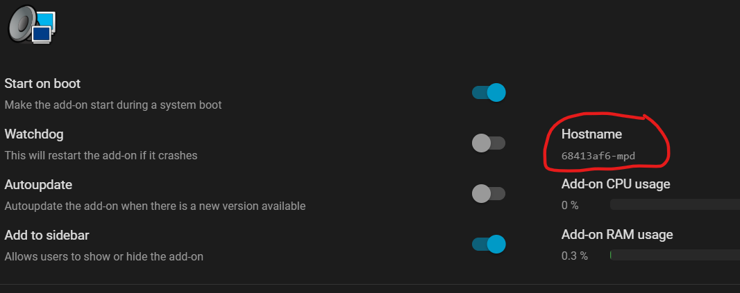

Removed the VLC and MPD. Reinstalled MPD and use all following options for host when adding integration and still cannot get the integration working
68413af6-mpd
127.0.0.1
HA IP

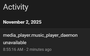

I get the error media_player.music_player_daemon off
I have no idea how a localhost address works in relation with a docker container.

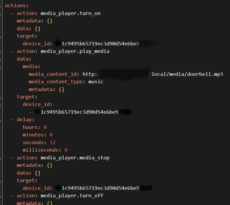

It seams the deamon by defult is set to off and in the automation you have to turn the MPD player on first then you can play the file.
What led me to this was the UI for Mobile where it shows a Power button beside the entity where you can turn it on. However, all along I was looking at the entity on desktop browser where it does not show the Power button beside the entity. (Picture that was posted 6 days ago)
I don’t recall the documentation said anything about the powering on the player in automation.
So, here is the action section of the automation for the MPD
