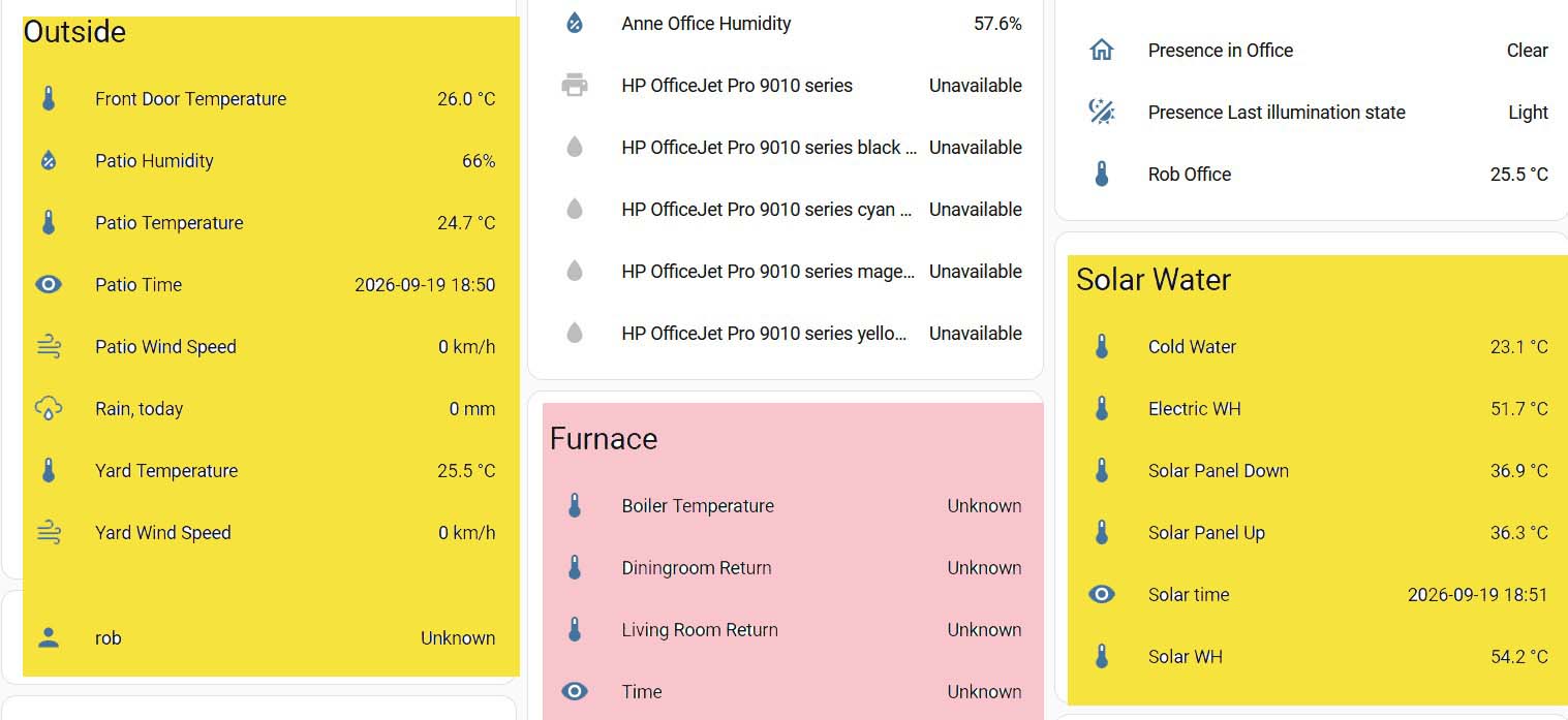

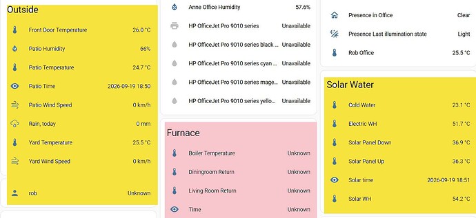

Today I configured a new computer to send temperature information from our furnace:
# Configuration.yaml entry for MQTT furnace sensors.
    - name: "Furnace Time"
      unique_id: furnace_time
      state_topic: "Furnace/Water"
      value_template: "{{ value_json['Time'] }}"
    - name: "Boiler Temperature"
      unique_id: boiler_temperature
      value_template: "{{ value_json['Boiler'] }}"
      device_class: temperature
      state_class: measurement
      unit_of_measurement: "°C"
    - name: "Living Room Return"
      unique_id: livingroom
      value_template: "{{ value_json['LivingRoom'] }}"
    - name: "Diningroom Return"
      unique_id: diningroom
      value_template: "{{ value_json['DiningRoom'] }}"
    - name: "Upstairs Return"
      unique_id: upstairs
      value_template: "{{ value_json['UpStairs'] }}"
Here are the entries in the MQTT Explorer:
Acurite
Patio = {"Time": "2026-09-19 16:49", "Temperature": 26.9, "humidity": 59.0,"wind": 5.0, "rain": 0.0}
Yard = {"Temp Yard": 33.3333333333, "Wind Yard": 0.2, "Temp By Pool": -40.0}
House = {"Front Door": 28.2, "Living Room": 24.1 , "Humidity": 57.0
Furnace
Water = {"Time": 2026-09-19 16:54, "Boiler": 24.437, "LivingRoom": 24.875 , "DiningRoom": 24.312, "UpStairs": 25.062}
Solar
Panel = {"Date": "2026-09-19 16:52", "Panel Down": 54.062 , "Panel Up": 50.187}
Water = {"Electric WH": 56.0, "Solar WH": 54.5 , "Cold Water": 21.625}
The furnace sensors are not being processes and is shown in the attched
screen shot - red area.
Can someone spot my error, I’ve looked without success. Thanks…RDK

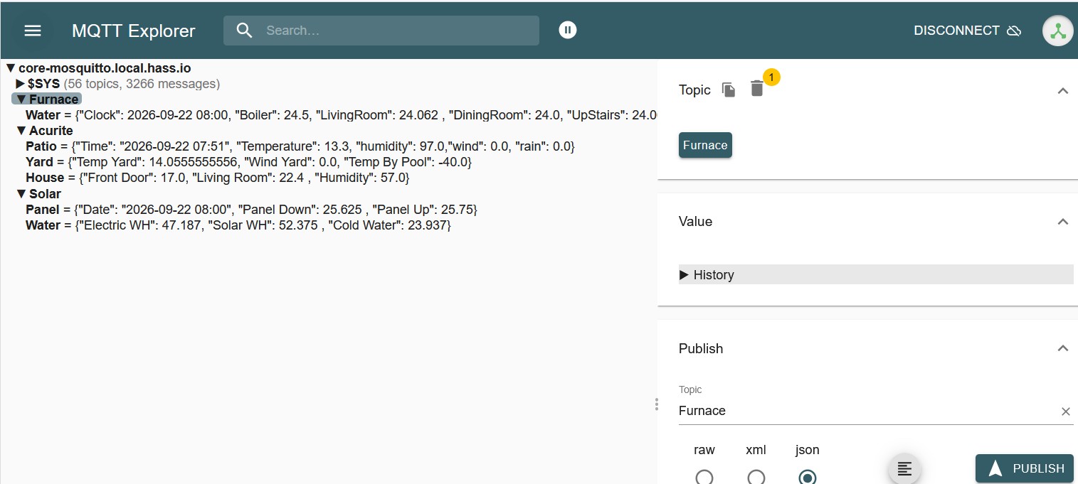

I’ve made some changes since I originally post this issue:
I noticed that the sensor name for the “Furnace” time was not what I coded in the configuration, ie “Time” and not “Furnace Time” as coded in the Configuration.yaml. One can also see this in the attached screen shot from the original posting:
      value_template: "{{ value_json['Clock'] }}"
I also noticed that there were two “Time” elements in my MQTT data, one for the"Patio" and one for the “Furnace”. Thinking that maybe that was confusing the issue, I changed the "Furnace one to “Clock”. This change had no effect on the getting the “Furnace” data into my HA display and all the other still work. And the mis-named Furnace time entry is still “Time”.
Also attached is a screen shot of the MQTT_Explorer. Thanks…RDK

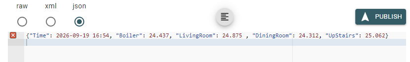

Issue fixed, dumb error. Time/data field was not enclosed in double quotes. Data now being displayed. Still don’t understand why the name is “Time” and not “Furnace Time”. Thanks…RDK

Thanks, that’s what I wanted in order to compare the payload you had posted as text to the actual payload as it appears in the screenshot. Why? To confirm the published payload for Furnace/Water is exactly what you had posted.
Your post shows:
but the screenshot shows:
"Clock": 2026-09-22 08:00
Those are two different key names (and both lack quotation marks for their payload). The lack of quotation marks instantly makes it invalid JSON and explains why all Template Sensors report Unknown.
The payload contains Clock instead of Time so it will cause this template, for Furnace Time, to fail to report the time:

BTW, MQTT Explorer indicates if the payload is invalid JSON (the “X” icon).
The “X” icon disappears when the time string is wrapped in double-quotes.
