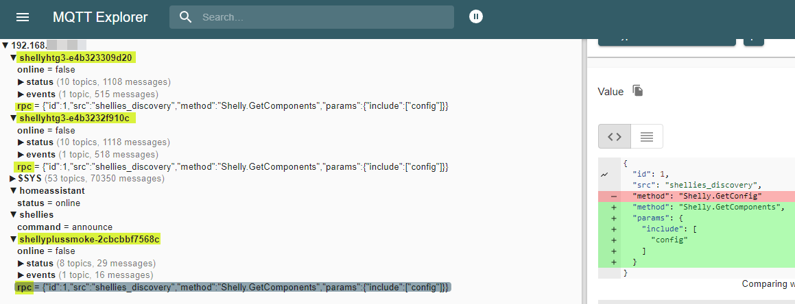

I see the Shellies in Mosquitto
With MQTT Explorer I see the correct values of the devices, connecting every 5 minutes (H&T) and delivering them

Devices should respond to the shellies_discovery topic, but that one is not visible in your screenshot.
How to debug
I can see shellies_discovery in the RPC part

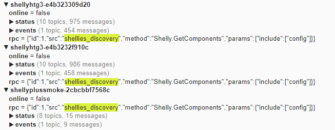

No, you can see the messages that Shellies Discovery sends to the device, you can’t see the response. Probably your MQTT config is wrong.

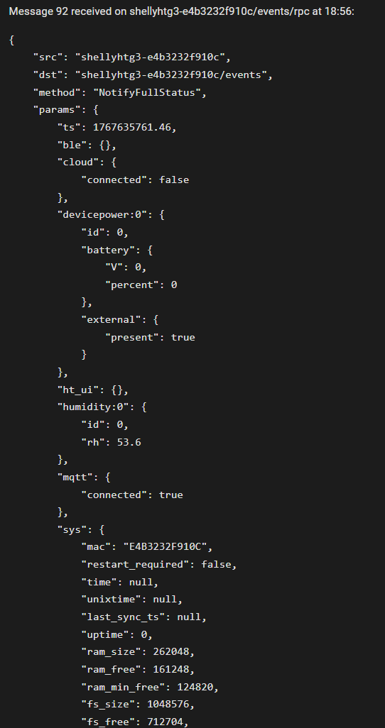

When I test the wildcard “#” listener in “Listen to a topic
the Shellies are contributing towards MQTT
How should MQTT behave from here, where do I need to check that everything is ok with my MQTT settings?
Shelly device must send the response to the shellies_discovery topic.
Remember that battery-powered devices (even if powered by USB) must be awake when the announce automation is triggered.

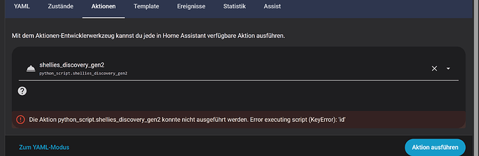

If I try to run the py script, the action task response:
The action python_script.shellies_discovery_gen2 could not be executed. Error executing script (KeyError): ‘id’
You cannot run this script manually, it needs data from the device response.

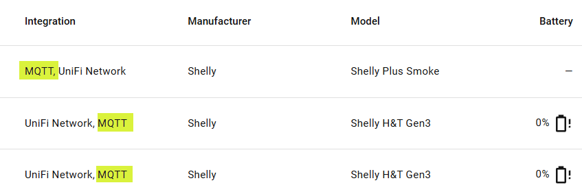

  • Ahh, okay. The script is working, I got all the shellies in my MQTT integration.
success
I was inpatient with such 3 seconds press on the H&T to get it really awaken. I was under the impression that a fresh power on does the same :thinking:
