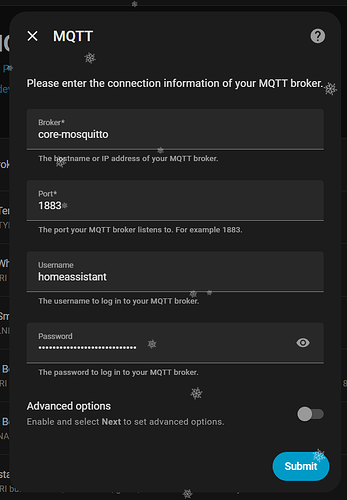

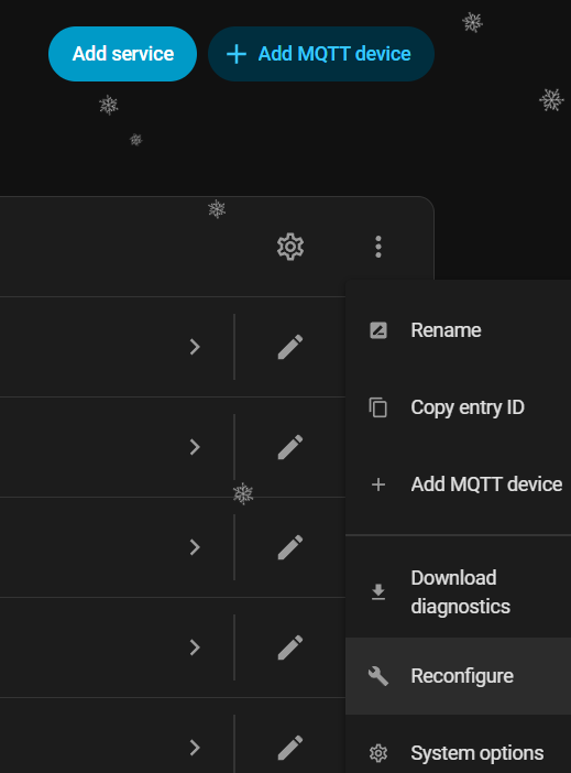

in the mqtt integration (not the addon broker), you can click the 3 dot menu, click reconfigure, then you can point the integration directly to your existing broker (instead of the mqtt addon).
I don’t know if this is better/worse/same as doing a bridge between the broker addon and your external broker.
From what I can tell, the mqtt integration will only support ONE broker.
Thanks for the information.
I reconfigured the MQTT Broker/Integration
I now have 2 issues.
  1. The reconfigure seems to accept an empty password and says that the reconfig was successful. However nothing shows up in HA
  2. The password filed keeps reverting back.
How do I know if this method is working?
