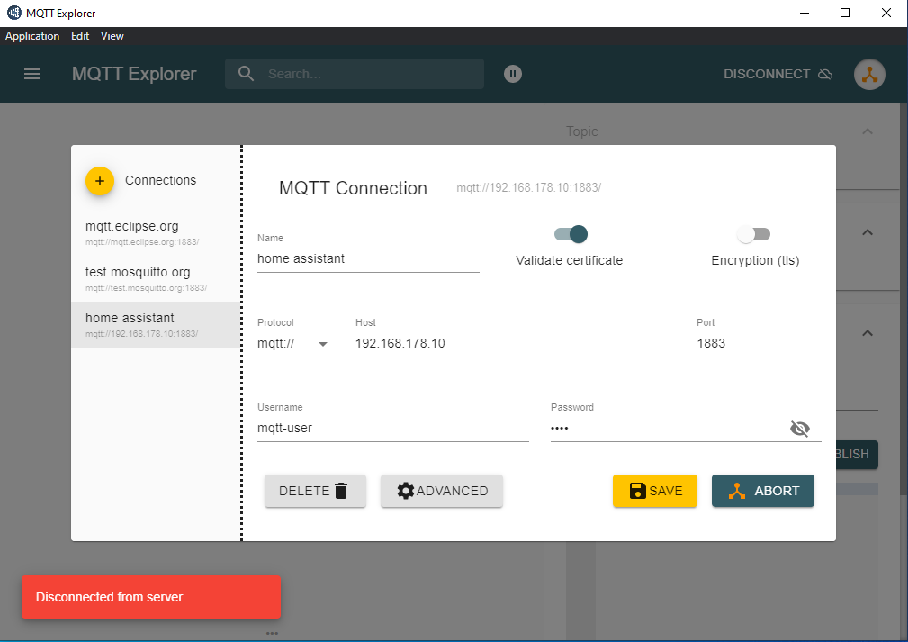

I tested connection with my laptop and MQTT Explorer and I also failed to connect to the broker, if my laptop is connected to guest access

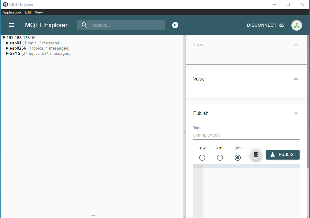

here my laptop was connected to “main” access
