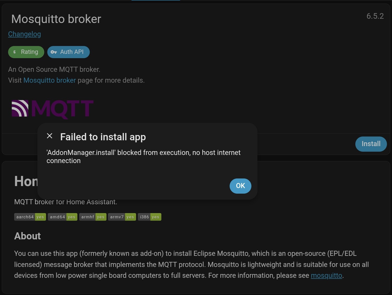

I installed home assistant on proxmox and im trying to install mqtt but getting error.
Appreciate it i can get some help.
Thank you.
It’s saying that HA can’t reach the internet to download the broker.

I tried chatgpt and it was determined that it has something to do with proxmox as we did change the dns to 8888 and 1111, its still not working.
