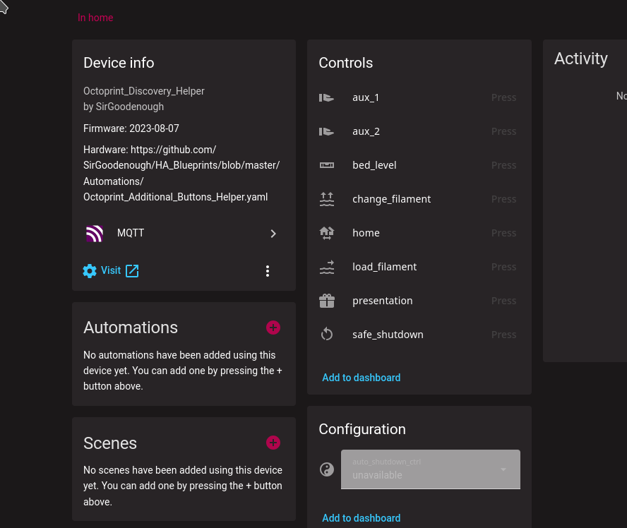

In this blueprint, the device section is the same on all these and they all show up in the same device.

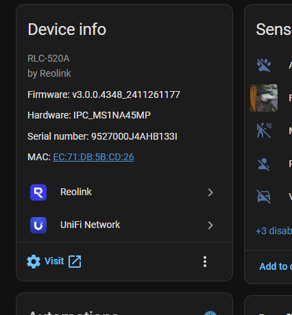

On my Reolink cameras in the device info section, it lists both the Reolink integration AND the Unifi Networks integration. (see below)
My assumption (there’s that word again ) was that it’s figuring out to link the two based on the MAC address, which the switch port would know as well as the camera.
I’ve seen other examples of this where a device will show other related devices from other integrations.

Okay that is a capability that I was not aware of / doesn’t fit with how I thought it worked. Please disregard my previous point about connections - clearly it does more than I thought.
Like I said, while I can see that HA has that ability, I don’t know if this field actually controls THAT, or if it’s for something else.
