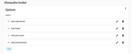

Now none of my devices are showing up in the integration. I have set up a new user in home assistant for the as mentioned in the add-on documentation.
I can see from the add-on logs that the users I have set for devices, including z2m, are logging into the mosquitto just fine (I set up additional users in the addon configuration page).

I have added mqtt_homeassistant, the user I have added to home assistant via the people panel for the broker, to the users in the mosquitto broker add-on configuration without success.

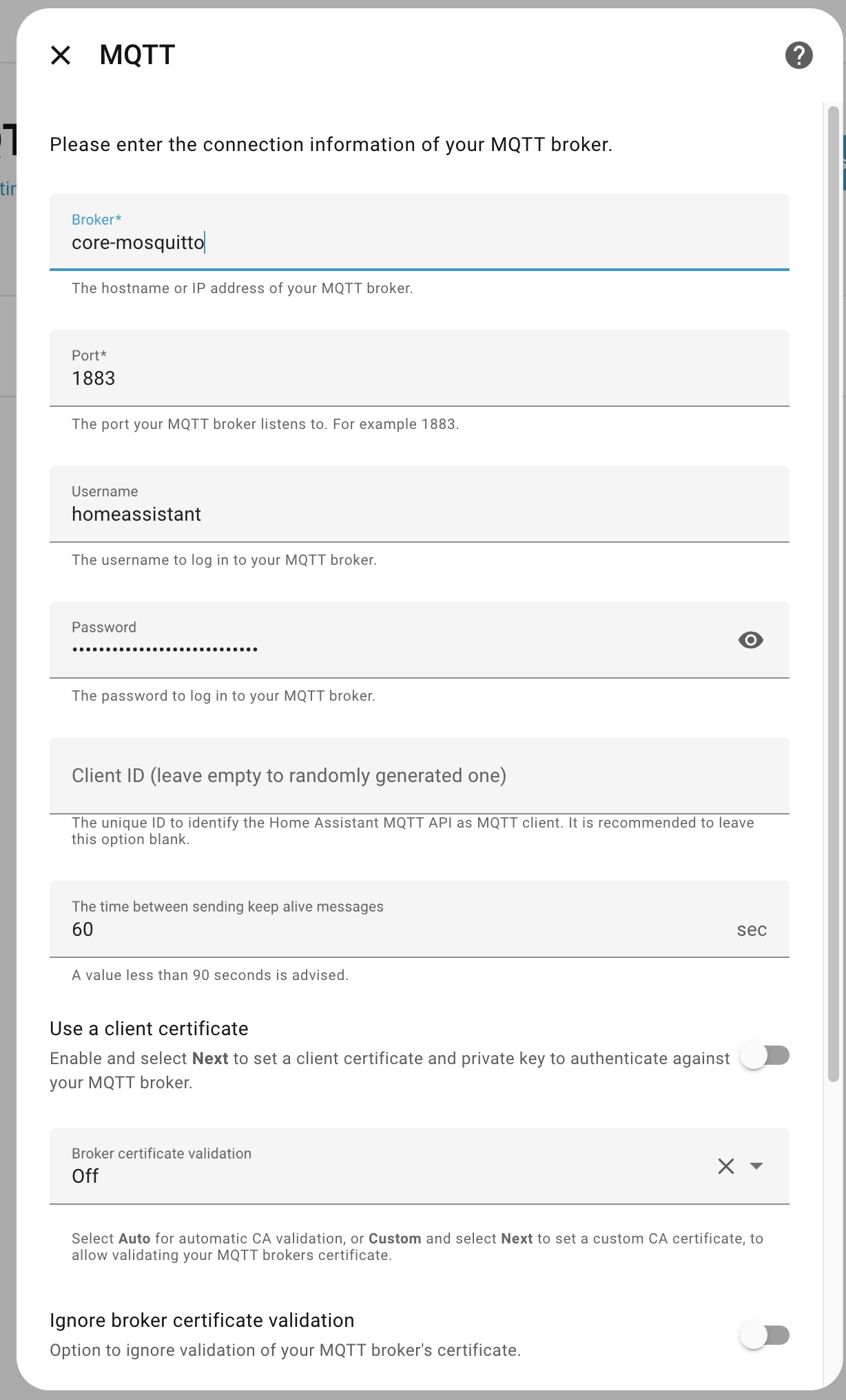

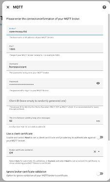

PS: Noticed this on the integration settings page. User is “homeassistant”, should this be changed? It is different to the user I set up in home assistant for the mqtt broker. Thought that “homeassistant” was a reserved username…
Changed that to the mqtt_homeassistant username and password. Still nothing coming through.

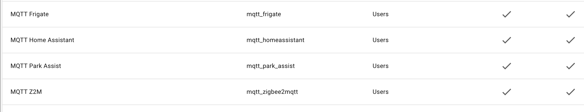

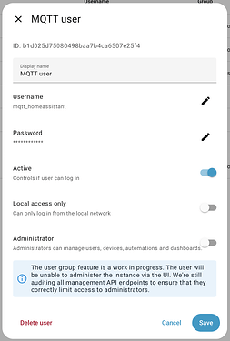

Added all mqtt users via the people panel in home assistant, as suggested in the add on documentation. Including mqtt_homeassistant, z2m, frigate and park assist users.
These users appear to be logged in successfully:

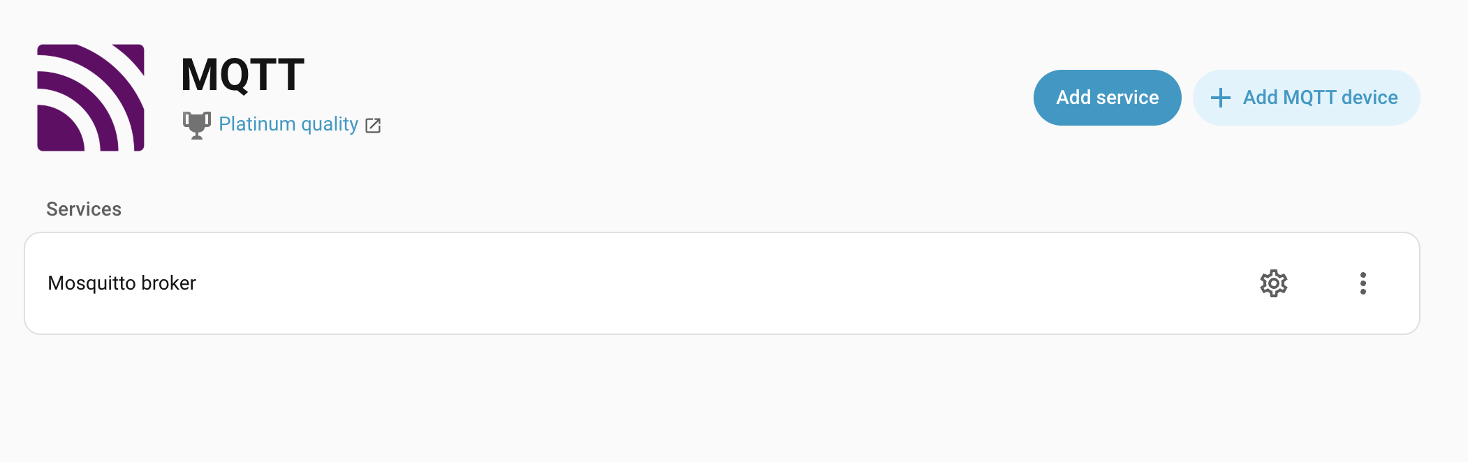

MQTT integration instantly detected in home assistant integrations. When added…
2025-11-08 12:08:37: New connection from 172.30.32.1:44327 on port 1883.
2025-11-08 12:08:37: New client connected from 172.30.32.1:44327 as 71BbwfYhMWPSsTebZ4vkKM (p2, c1, k60, u'homeassistant').
No MQTT devices listed in the integration:
