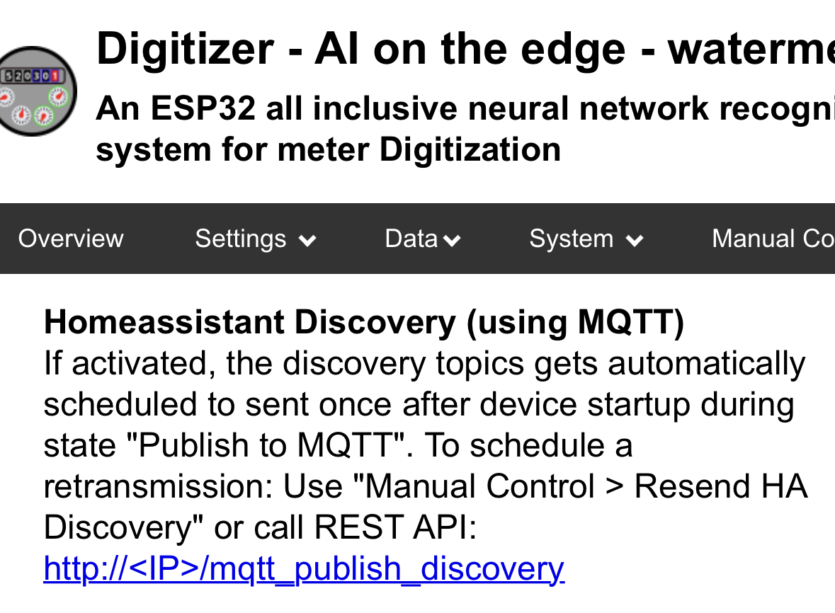

The MQTT autodiscovery payload should be sent when the ESP cam restarts, but if not, you can choose “manual control” → “resend Homeassistant discovery”. As mentioned here in the config settings:
