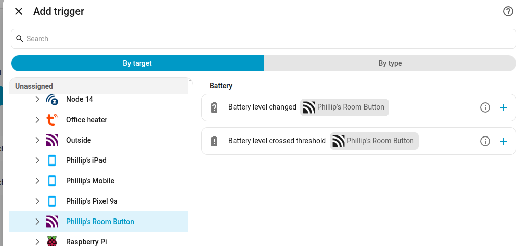

Am I misunderstanding the purpose of the trigger, or what it actually is? The intent is to send a message when the device wakes up, which will trigger an automation in HA to toggle the state of some switch devices. If I create an automation, and add a trigger, the device is showing but only the battery voltage and charge state are listed as options - ditto in the device screen itself.
