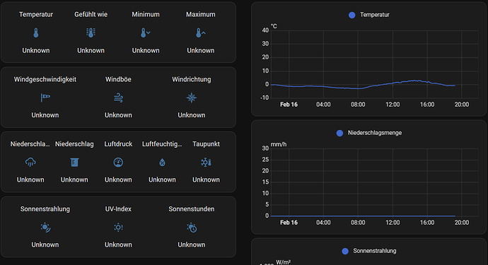

I read in my weather station data from CumulusMX into Home Assistant via MQTT. Works fine in principle, but when I reboot the system, all sensors turn to ‘Unknown’.
The data still arrives as far as I can tell (from the timestamp) from the MQTT explorer:

Few hours ago I shut down the system temporarily and the sensors are Unknown again.
Does anyone have any clue how that might be solved? Re-installing everything after every reboot is obviously not an option. Especially since I plan to have the system reboot every night.
