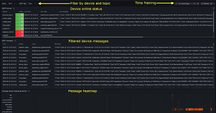

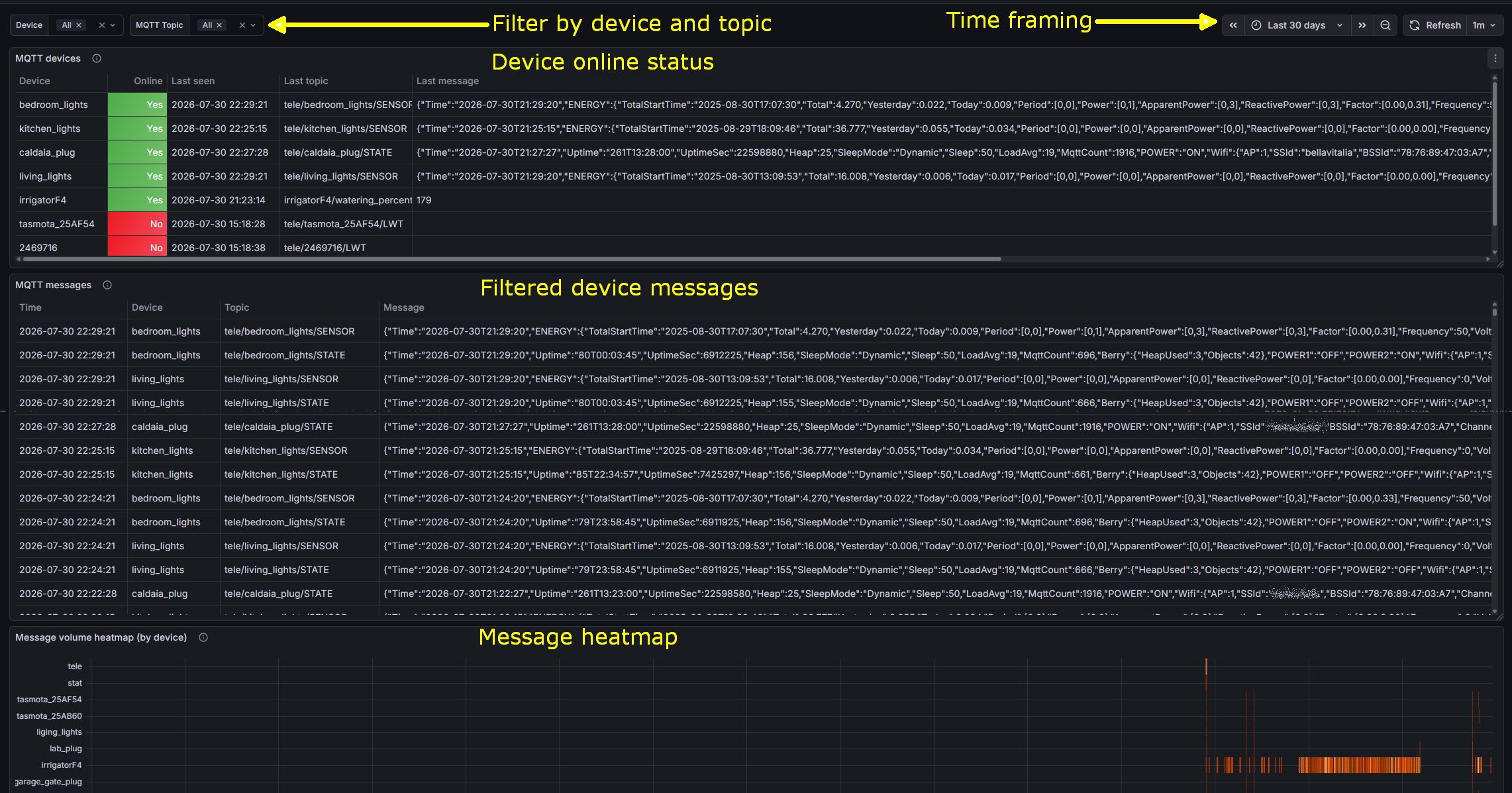

What is does:
  1. Listens to (almost) all MQTT messages in HA MQTT broker.
  2. Writes them to Loki.
  3. Filters them to Grafana dashboard. You can control the filtering by device name, topic, and time window. The MQTT viewer made easy (for me) - constructive feedback for further improvement is welcome! :slight_smile:

MQTT Logger and browser
Logs every MQTT message seen by your Home Assistant broker into Loki, then gives you a Grafana dashboard to see which devices are online and to search the raw message history - filterable by device and topic.
