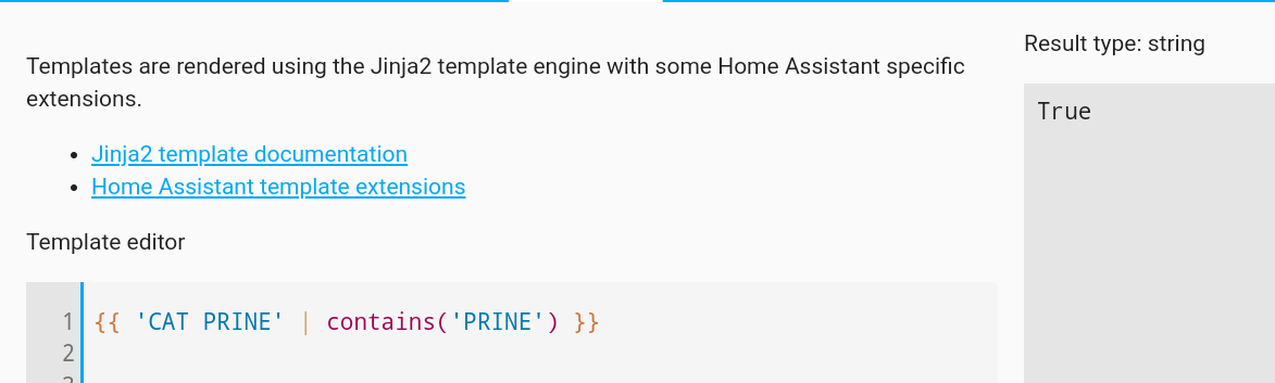

My suspicion too, but it looks like regex_search handles lists:
contains handles strings as well. Now that both regex_search and contains have failed to produce the desired result, I think we need to look for clues in the trace file.
