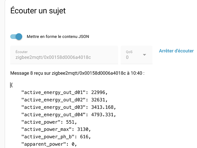

In HA, MQTT integration, I configured that I think right. I receive respond message successfully.
But, no entry . Nothing. After one night, not yet discovery.
In integrations settings, when I tried to listen topic, It works.
And I can write in topic and see homeassistant topic to be sure with mqtt ACL.
I tried to add new device from zigbee2mqtt, It works in zigbee2mqtt, but not appears in HA.
