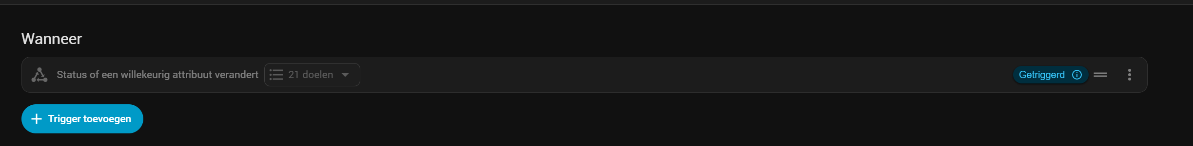

When the automation fires automatically (via time_pattern or state trigger), Domoticz receives nothing. Although I see by “When” the triggering.
if I click show tracing, I see no information

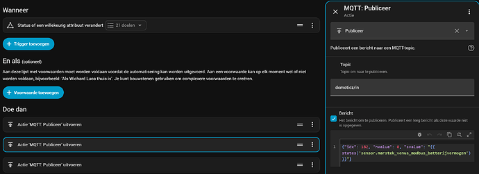

this is my automation yaml:

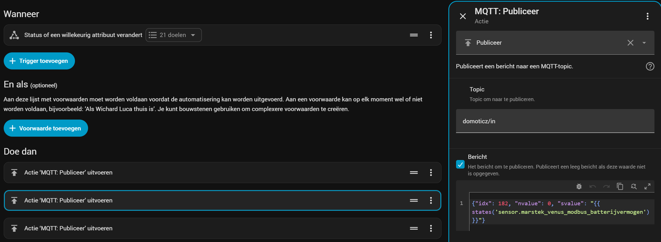

      actions:
  • data:
    topic: domoticz/in
    payload: >-
    {“idx”: 181, “nvalue”: 0, “svalue”: “{{
    states(‘sensor.marstek_venus_modbus_batterij_soc’) }}”}
    action: mqtt.publish
  • data:
    topic: domoticz/in
    payload: >-
    {“idx”: 182, “nvalue”: 0, “svalue”: “{{
    states(‘sensor.marstek_venus_modbus_batterijvermogen’) }}”}

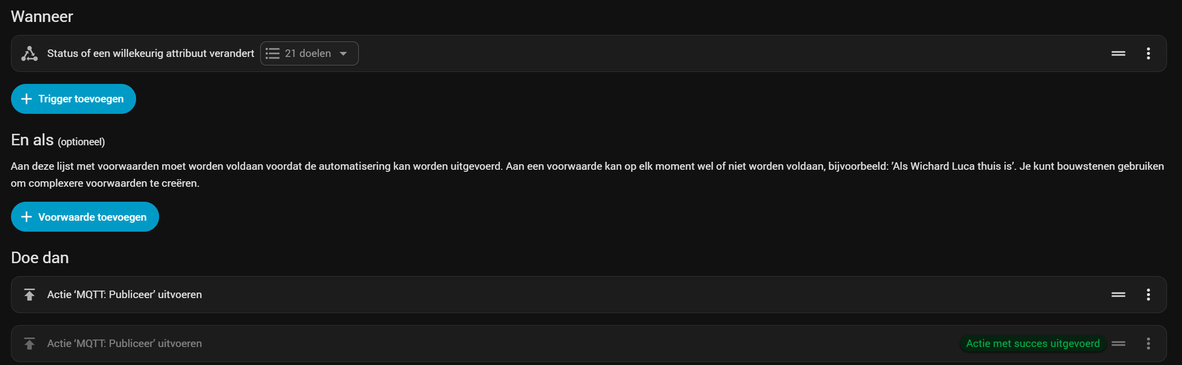

Same topic and payload work perfectly from Developer Tools and manual “Run actions”, but an automatic trigger produces no MQTT message reaching Domoticz. The automation is confirmed to be enabled and firing.

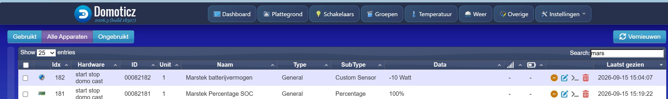

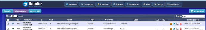

When I run it manually it is succesfull and I see the change from the value in domotcz
Why would mqtt.publish work from Developer Tools and manual “Run actions”, but silently fail / does not change value in domotcz when triggered automatically?
Any suggestion what I’m doing wrong?
