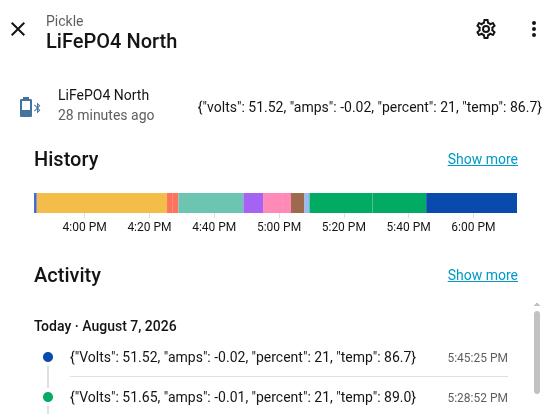

However, subsequently sending this sensor state data to topic homeassistant/sensor/pickle-bms-1/state using this json isn’t working as expected or desired:
  "volts": 51.52,
  "amps": -0.02,
  "percent": 21,
  "temp": 86.7
What I see is raw JSON data, which isn’t parsed as specified by the config block value_template values:
Can anyone point out what I am doing wrong? I would be eternally grateful! Thanks…
- Michael
Hello Michael ,
Troubleshooting MQTT? MQTT-Explorer can help you be successful!
If you have Apps available, try adding this App repository to your Apps list. GitHub - GollumDom/addon-repository · GitHub.
With this you can see that the broker sees and likely find the bug.
HINT: I have found using this, if you look at the JSON string and it is in color, the JSON is valid. If it is monochrome, the JSON is invalid and it will not work.
